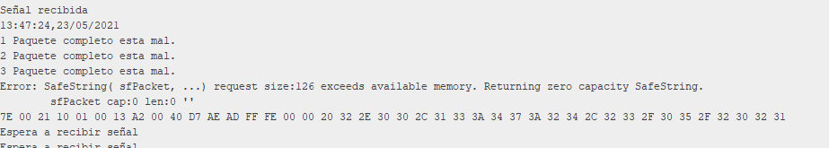

I try and show me this.

Hi Mr. Drmpf, men Im sorry for this. I was tested the program with ADC on. Last time I only compile in the IDLE of Arduino and dont show any error. But today I do a Test, and look haha I think the data it much larger than the operation I dont know.
This is the code I run Today:

        if ((idx + 6 + 19 + 1) > sizeof(fullPacket)) {
          Serial.println(F("Paquete completo esta mal."));
       float voltPanel= ((float(analogRead(ADCpin))*5.0/1023)*6+10, 2);//Obtengo del ADC el voltaje
       //Realizo una operacion y = mx + b para obtener el valor real del Panel Fotovoltaico.
       cSF(sfVolts,6); //Voltage xx.xx == 5 y coma 1 == 6
       sfVolts.print(voltPanel,2,5); // "xx.xx" o " x.xx" o "-x.xx" o "xxx.x"
       sfVolts.print(',');
       memmove(fullPacket + idx, sfVolts.c_str(), 6); // Siempre van a ser 6 caracteres de largo
       idx += 6;
       if ((idx + 19 + 1) > sizeof(fullPacket)) {
         Serial.println(F("Paquete completo esta mal 2."));
       memmove(fullPacket + idx, buffer, 19);
       idx += 19;
       //Dejo un ultimo byte para tener el Checksum.
       if ((idx + 1) != sizeof(fullPacket)) {
         Serial.println(F("Paquete completo esta mal 3."));
       //Se le da el formato al paquete completo
       size_t printSize = idx * 3;
       cSF(sfPacket, printSize);
       for (size_t i = 0; i < idx; i++) {
         //sfPacket += "0x";
         if (fullPacket[i] < 16) {
         sfPacket += '0';
         sfPacket.print(fullPacket[i], HEX);
         sfPacket.print(' ');
         Serial.println(sfPacket);//Se comprueba que el formato de la Trama API.
         XBeeSerial.write (fullPacket , idx);//Se envia la trama del sensor a la PC.

When I tested before this new change, the black window say this:
" Sketch uses 24756 bytes (76%) of the program storage space. The maximum is 32256 bytes.
Global variables use 1512 bytes (73%) of dynamic memory, leaving 536 bytes for local variables. The maximum is 2048 bytes.
Going to try with this new option.
With the new option the black window say this:
"Sketch uses 24428 bytes (75%) of the program storage space. The maximum is 32256 bytes.
Global variables use 1508 bytes (73%) of dynamic memory, leaving 540 bytes for local variables. The maximum is 2048 bytes."
So I tested and have this
Which doesn't work the way I expect.
Well, as I had explained before, I managed to send an API frame with the time and date from the arduino to the computer. Then what I did was a small loop at the beginning so that it was constantly asking if it has received a message, the moment it receives it, it begins to send information without stopping, which is what I am looking for for the sensor.
But when it comes to involving the ADC in the programming, something strange happens besides that I run out of memory haha but it is not sending me information once I send it a signal from the computer. Just like he only sent me a plot haha
You still have the cSF(sfPacket, ) statement.
Remove that.

Oh and I see, the arduino print this Serial.println(F("Paquete completo esta mal."));
So that mean something bad happen , no the same size of the full packet
        size_t idx = 0;
        memmove(fullPacket + idx, packet1, sizeof(packet1));
        idx += sizeof(packet1);
        memmove(fullPacket + idx, packet2, sizeof(packet2));
        idx += sizeof(packet2);
I see that you used the F macro in the serial print in your last fragment. You have several other prints that could use it too if you're still trying to reduce your RAM footprint.
You removed this bit of code so the packet size is not correct now
Also change your error msgs so you can tell with section fails e.g.
Serial.println(F("1 Paquete completo esta mal."));
Serial.println(F("2 Paquete completo esta mal."));
Serial.println(F("3 Paquete completo esta mal."));
etc

Ok ok
I see that in the header I didnt change the number of the bytes. So I changed.
At least eliminate the errors that we had at the beginning, those of "1 Paquete completo esta mal"
