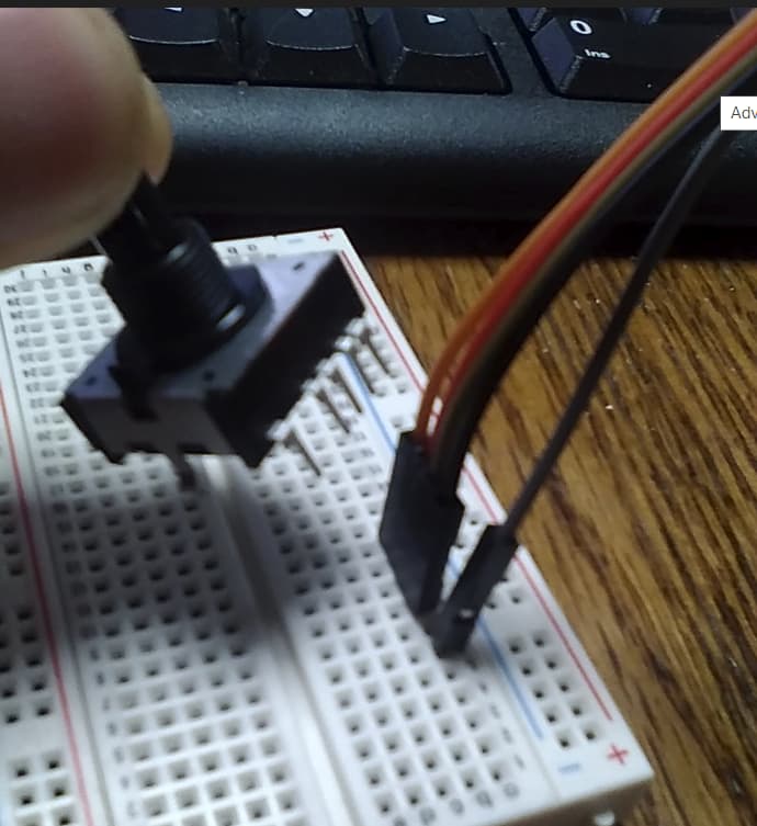

Here is an image of my encoder:
I have the outstanding pin setup to the Arduino ground. The four "A" pins are connected from Arduino to the four on the encoder.
More pics:
The datasheet says the middle pin is the common. Which one is true? Maybe neither.
Between the data sheet and some guess based on the pin geometry, I'd go with the data sheet.
Which, BTW, doesn't even list the weights of the four switches.
a7
@stitech @alto777 @DaveX I am now getting a different value for each encoder position. I had the ground in the wrong spot. I would've never guessed that the common is in the middle. I am now trying to make the lookup table to get my sequential values. Thanks for the help!
