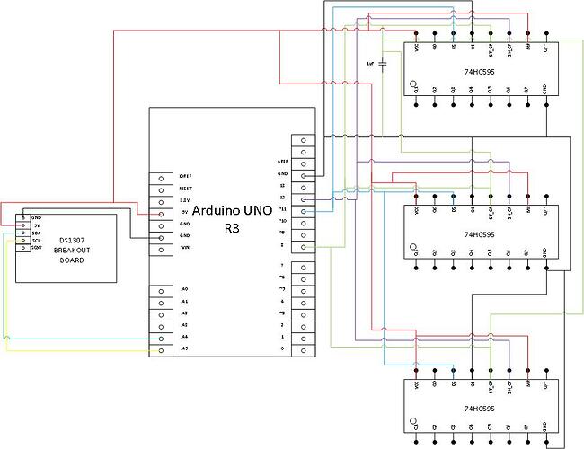

I am in the process of building an Arduino powered 16 x 7 LED clock. I am currently working on getting the idea of the wiring right so that when I actually start putting it all together I have something to look at. I am just wanting to get some other opinins and see if anyone has any suggestion on how I could make this more efficient or let me know if it is good as is. Thanks for any input!
Here is what I have:
Hi and welcome.
You have 1 capacitor in there.
Use a 100nF capacitor real close to any of those 595's, so 3 pieces.
Also, you seem to plan to have all 3 displays show the same content.
You have created one double loop (the light green line) that is connected to all 3 595's.
Loops can be very interesting, but i don't think you're looking for that at the moment.
And 2 (blue and purple) other lines that are connected to all 3 of the 595's also.
That means you are sending the same data to all 595's without any addressing or distinction what data is meant for what 595.
I think you want to connect the 595's in series.
That means the first one gets its data, and will overflow into the second one that will overflow into the third one when receiving data.
The 595 has a data out pin (pin 9) for that.
So you send 3 bytes to the first 595 and the first will end up in the 3rd 595, second in 2nd and third in 1st.

Do you mean a matrix of leds 16 wide by 7 high? Or 16 x 7-segment led displays?
Either way, you are going to have a problem. Each output from a 595 can either source or sink enough current for a single led. But they cannot source or sink enough for a group of (either 7 or 16) leds. You will need an extra chip for that, or some transistors. You could:

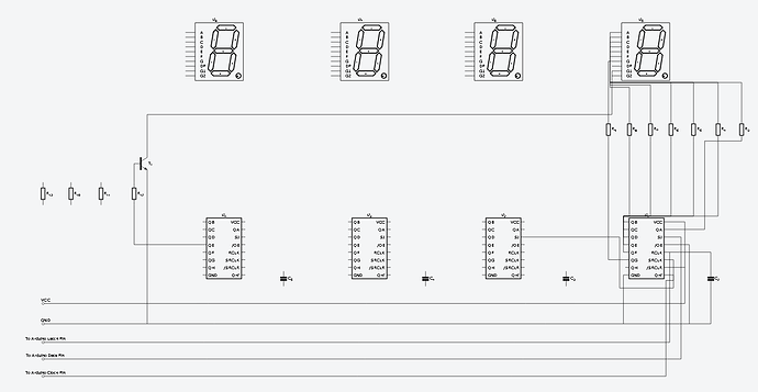

Sorry it has taken me so long to get back on here, I have been busy trying to support my hobby. Anyway, I have switched from doing individual LED's to using 7-Segment Common Cathode Displays (4 of them). I have started the schematic and just wanted to get some opinions again before I finish it. I have a resistor in between each output of the 595 and the inputs for the 7-segment, they will be 220 ohm, and the resistor in between the the transistor and the 595 ( no. 4) will be 1k ohm. How does this look?
Might want to add a capacitor from Vcc to Gnd for decoupling, .1uf
I don't understand your design now!
If you have one 595 to drive each 7-seg display, you do not need to multiplex, and do not need any transistors.
Alternatively, you can use only 2 x 595s and 7 or 8 transistors (or a single ULN2803) and use multiplexing. But I would recommend using 4 x 595 over multiplexing. Multiplexing will reduce the average current down to 2.5mA per segment, v. 10mA if you don't multiplex.
Your circuit above seems to be somewhere between the two ideas, but because you haven't completed the wiring, I can't tell which approach you are trying to take. So please explain a little more: multiplexing or not?
Also, what is the forward voltage (Vf) and max current of those 7-seg displays? Your series resistors should be calculated from those figures, but also to avoid overloading the 595s.
If you are open to design changes (and I think you are given you have abandoned your original dot matrix design), I would suggest simplifying by using a single max7219 or saa1064 driver chip instead of the 595s.

Thanks for getting back so quickly! Haha, my brain hurts, I feel like this should be easy but I keep getting hung up. Okay, so I will not need the transistors because I will be using all 4 595's, not multiplexing, right? Also the max forward voltage for the segments is 30mA and the voltage is 2B [typical 20mA & 1.7 V]. The figure that I got for the resistors was 100 @ max and 165* @ typical, but everything I could find online everyone was using 220 ohm resistors for some reason.
Also, are the capacitors placed correctly. I found a few different ways that people had them hooked up, this one just seemed to make sense to me. Also, above someone suggested I place one in between BBC and GND, yea or nea?
... As far as design changes I am totally open but I already have the 595's so I'm just gonna use them. I'm just ready to get this thing complete, haha. For future purposes though I will definitely try those other suggestions.
OK, so no multiplexing. Keeps the sketch and hardware simple and your displays nice and bright.

If your displays have a Vf of 2.0V and your Arduino is supplying 5.0V (via the 595s), you need to loose or "drop" the other 3.0V. The 595s can only supply around 80mA each so 10mA per segment. Now you need to use Ohm's law R = V / I = 3.0 / 0.01 = 300 Ohms. In practice, the outputs will probably be a bit less than 5V, especially when you draw 10mA, so you might get away with 220, but I would play it safe if I were you.
For those caps, yes, they go from 5V to GND. One per 595 chip, as close to the chip as you can easily get. If you are prototyping on breadboard (and I do recommend you do that), just put the caps across the breadboard's power rails next to each 595.
