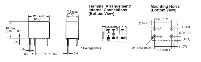

I'm using Omron G5V-1-DC5 relays. They have 6 pins (2 for the coil (pins 2 and 9), 2 for each "throw" (pins 1 and 10), and two more that a wired together internally (pins 5 and 10 to close the circuit on the throws).

You know, I looked at the google images, but the light over my head didn't go off. The link to the tutorial you posted was just what I needed. The text cleared things right up! I think, do I have this right?
I need to tie the Normally Open (NO) contacts together with the + of my 12V supply and the Normally Closed (NC) contacts together with the - of my 12V supply, and the common contacts all go to ground. And the ground must be common to both the Arduino and 12V actuator supply, correct?
I need to tie the Normally Open (NO) contacts together with the + of my 12V supply and the Normally Close contacts together with the - of my 12V supply,
Correct so far.
Wrong, the two common contact wire to the two terminals of your actuator.
Not if your using +5vdc relay coils that get there power from the Arduino board.
Study the picture that KE7GKP closely and you will see there is no connection from the 12 volt negative to the arduino ground.
Ahh, my schematic reading skills are rusty (or, more likely, non-existent). I see the common contacts connected to the motor in the diagram now.
Also, I misread some of the text in the tutorial, the need for common ground was for running a motor off of a transistor using only onboard supply.
So NO goes to +12V, NC goes to -12V, common goes to each side of the actuator. Arduino and Actuator each have independent +/- (which is the whole point of using relays here of course).
