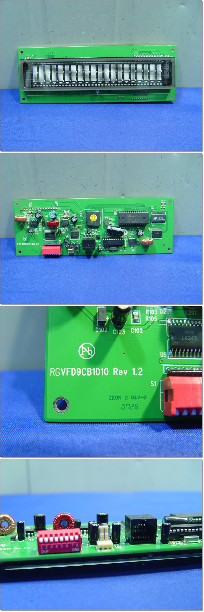

Hello.
I have recently aqiured a VFD display from an cashier, and I would like to change the text on it via Serial. My problem is; whenever i press the "Esc key", the display writes an "r", when I press the "8" key , the display clears. So the problem is mainly that I get completly different characters displayed in the display from what I am sending to it, and I have no clue of what might cause it (basicly every key correspons to another on the display).
The display is 20x2 VFD, model RGVFD9CB1010, Rev 1.2.
There are 8 DIP-switches on the display, which can be used to set different options. I have all mine set to ON (DOWN).
This should set the display to Firich/CD5220 Command Set, USA Character Set, and at 9600 Baud Rate. When the display is turned on, I get:
Customer Display
Mode: A Baud Rate: 9600
So I have set the display correctly.
I do not have an USB to RS232 serial converter, so I am using my Arduino UNO instead. I have removed the ATMega328P IC from the board, and connected RX from Arduino to TX in display, and TX from Arduino to RX in display. When ever I send a character from my PC, I get a character on the screen, but it is not the correct one. So I know there is connection between my PC and the display.
