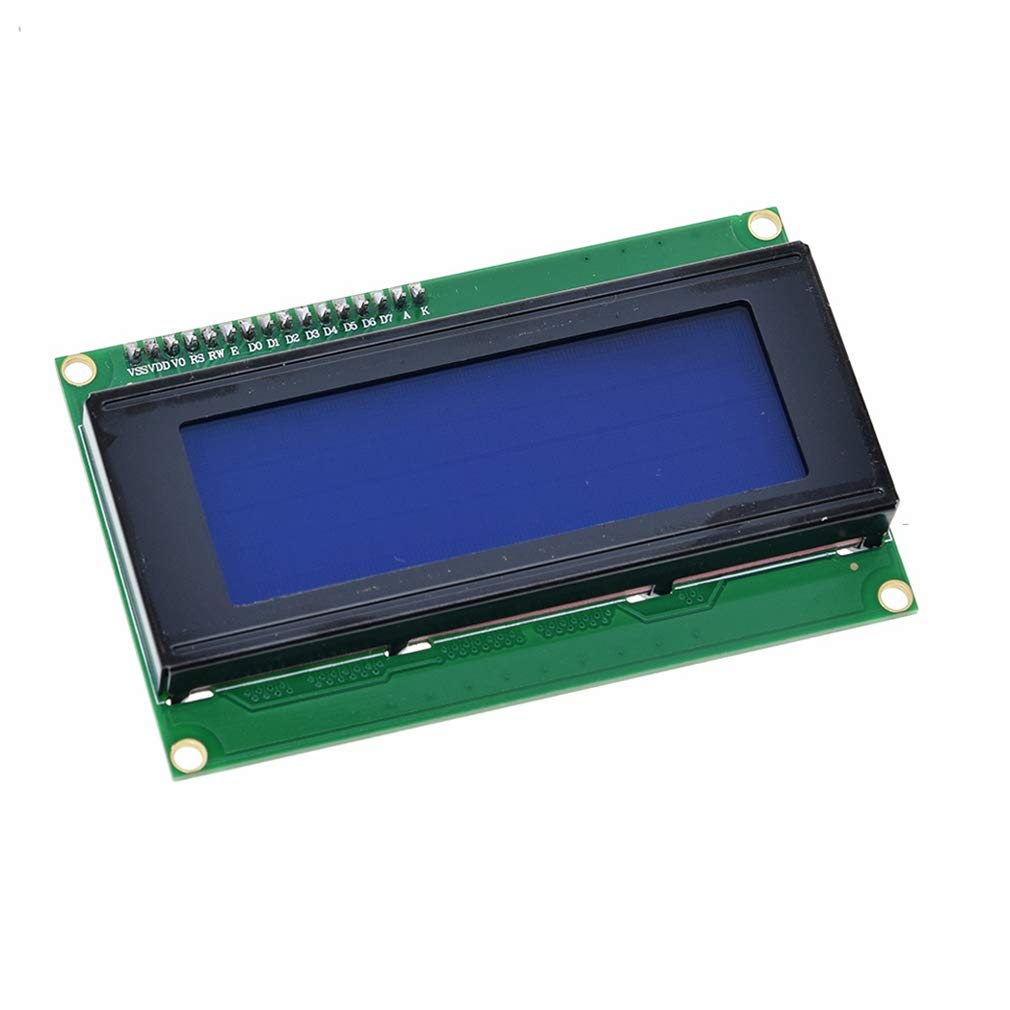

HI all.
I have an Amazon i2C screen, I am using the liquidTWI library, unfortunately it just flickers when I try to use the example sketch and never displays anything.
I used a test sketch and serial monitor to confirm the address of the I2c and it is correct.
When I use the wrong address the screen stays static but when i upload the test sketch "hello world" it flickers.
Any ideas?

The screen appears to be recognised as connected correctly as the code for getting the i2c address via serial monitor works great.
The connections are as follows
Clock from screen -> A5
Dat from screen -> A4
Vcc-> +5v ( also tried external +5v injection and also stand alone external +5v power with no change)
GND -> common ground

Im not sure how to upload the video here.
I hope I explain well but if I purposly use the wrong I2C address, the screen just stays solid blank, if I use the correct I2C address then it flickers like mad.

Have you tried a different library? I would highly recommend hd44780 - Arduino Reference
This works with my LCD.
// Set for 1 display with 4 rows of 20 columns
LiquidCrystal_I2C lcd1(0x27,20,4);
  lcd1.init();
  lcd1.backlight();
  lcd1.clear();
  lcd1.setCursor(0,0);
  lcd1.print("LCD 1");
Thank you, sorted now seems it was a bad library :slight_smile:
New library and it works
...and you can use multiple displays with this library.
