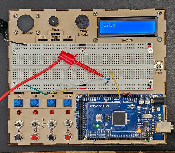

I guess I needed to step away & work on something else! Once I did, it popped into my head that I needed to change the resistor values in my voltage divider to bring down the max voltage from 5v coming out of the divider to 2.47v. Once I executed the “analogReference(INTERNAL2V56)” command, then the voltage was scaling properly. Now, the voltage on the LCD matches my DVM.
Thank you for your detailed explanations. I just needed to let them rattle around the back of the my brain and process for a while!

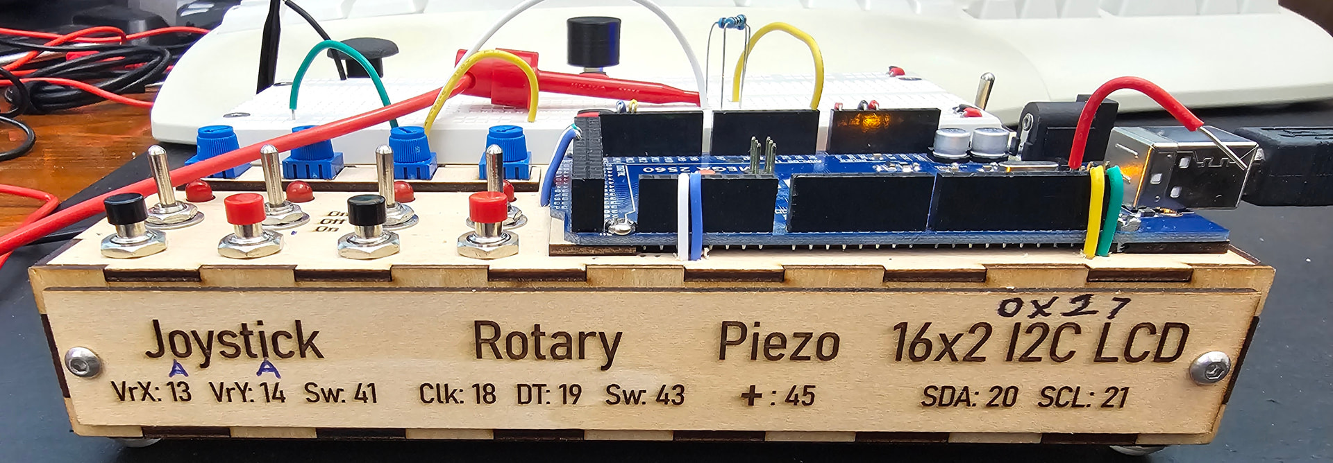

This is the prototyping box I built to make it easy to experiment with:
