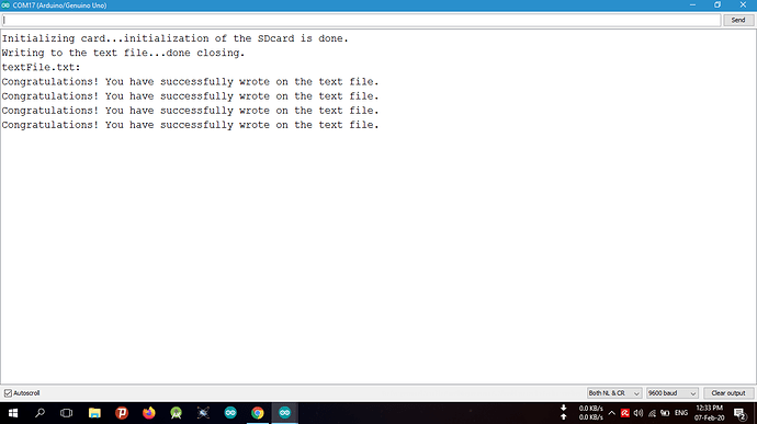

I need to store a single line of data in csv file stored in sd-card module,but the data was written two times on two line at every upload the code on arduino.
what is the problem?Can you help me? thank you.
I uploaded a screen shot for the result on the serial monitor(1.png).
This is the code:

But every running the sketch , two new lines were written in the csv file, not one line !
I can't see why, unless your sketch writes and then gets restarted somehow.
What does your serial output say?

After every uploading the sketch two lines of data were written in the serial monitor as in the file
for example:
Congratulations! You have successfully wrote on the text file.
For example doesn't help. Please run the code, capture the serial output and post it.

Ok.I'll upload a screen shot for the output on serial monitor.
You can find it in the attachment (1.png).
What do you get if you run it again?
