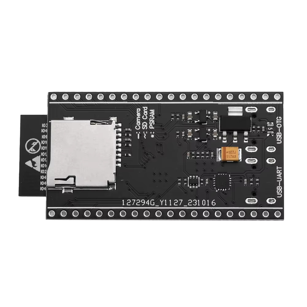

The actual code you posted shows your using the SD card in MMX mode.
That board appears to only have clk, cmd and d0 connected to the SD card, those are marked on the top of the board with a ~.
So why\how are you trying to use d1,d2,d3 ?
I just follow the library, but I don't know which pins are connected to this type of esp
Have you checked the pin map diagram for your board ?

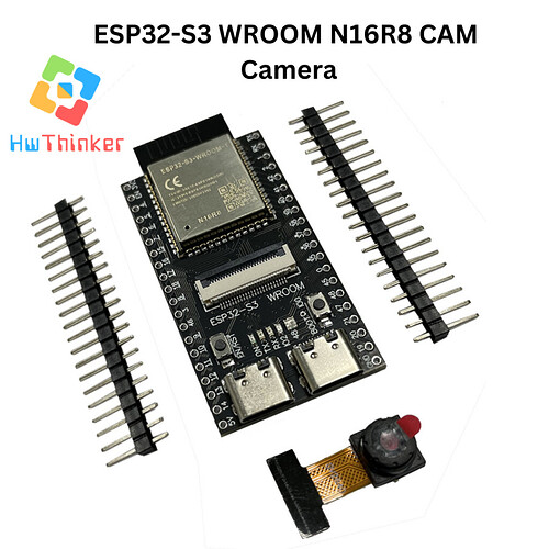

I got a freenove esp32-s3 wroom cam board..
pretty sure it has the same pinout as yours..
their sd example looks different too..

I had one of the ESP32S3 Camera Dev boards on the bench.
The code you posted works on my board.
