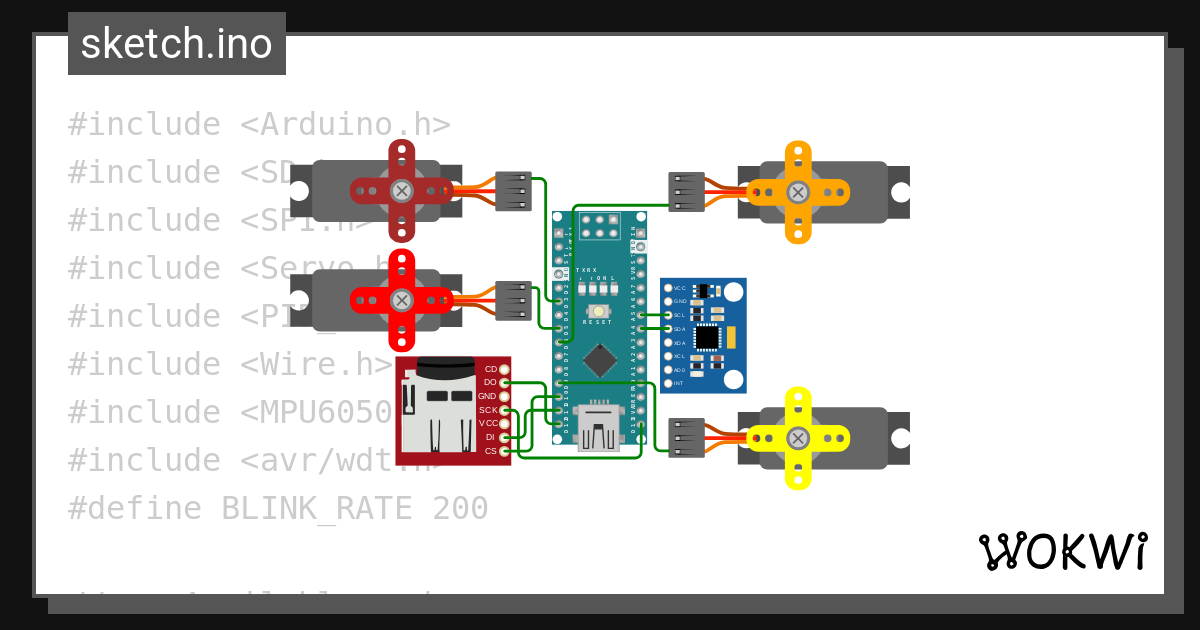

Hi everyone,
I’m working on a active fins controlled rocket flight computer using Arduino Nano with an MPU6050 and a microSD card module.
The code is created to have various modes selectable from the serial via an app made in external processing.
Talking about the topic, i'm using the SDsetup() for write the header for the csv (it's a txt but i'm going to convert in csv).
In dataLogger() i use checkInterval() for write the log values every 50ms and than i write all the relevant datas for post flight analysis.
The file log.txt is created successfully at startup, and the SD card is recognized, but during flight no data is written, moreover when I implemented the dataLogger function the mode change stopped working and the Arduino no longer responds to serial commands
I’ve already checked the hardware and the SD card works fine.
Here is the code:

void SDsetup() {
  //Iniitialization
  printDebug();
  Serial.println(F("Inizializzazione SD..."));
  if (!SD.begin(10)) {
    Serial.println(F("Inizializzazione SD fallita!"));
    SDnotFound = true;
    printDebug();
    while (1);
  Serial.println(F("SD inizializzata correttamente."));
  SDnotFound = false;
  printDebug();
  //Opening file and writing header
  logFile = SD.open("log.txt", FILE_WRITE);
  if (logFile) {
    logFile.println(F("Stinger logging system online"));
    logFile.println();
    logFile.println(F("Time,AX,AY,AZ,GX,GY,GZ,GXF,GYF,GZF,OUTX,OUTY,OUTZ,ANGX,ANGY,ANGZ,S1,S2,S3,S4,OFFX,OFFY,LAUNCHED,MODE"));
    logFile.flush(); //Ensure data is written to SD card
void dataLogger() {
  if (checkInterval(50)) { //Write every 50ms
    logFile.print(millis()); logFile.print(",");
    logFile.print(accX); logFile.print(",");
    logFile.print(accY); logFile.print(",");
    logFile.print(accZ); logFile.print(",");
    logFile.print(gyroX); logFile.print(",");
    logFile.print(gyroY); logFile.print(",");
    logFile.print(gyroZ); logFile.print(",");
    logFile.print(gyroXFiltered); logFile.print(",");
    logFile.print(gyroYFiltered); logFile.print(",");
    logFile.print(gyroZFiltered); logFile.print(",");
    logFile.print(outputX); logFile.print(",");
    logFile.print(outputY); logFile.print(",");
    logFile.print(outputZ); logFile.print(",");
    logFile.print(angleX); logFile.print(",");
    logFile.print(angleY); logFile.print(",");
    logFile.print(angleZ); logFile.print(",");
    logFile.print(servo1Angle); logFile.print(",");
    logFile.print(servo2Angle); logFile.print(",");
    logFile.print(servo3Angle); logFile.print(",");
    logFile.print(servo4Angle); logFile.print(",");
    logFile.print(offsetX); logFile.print(",");
    logFile.print(offsetY); logFile.print(",");
    logFile.print(launched); logFile.print(",");
    logFile.print(currentMode); logFile.println(); //Close line
void printDebug() {
  //Print data for debugging
  Serial.print(F("AX:")); Serial.print(accX, 2); Serial.print(" ");
  Serial.print(F("AY:")); Serial.print(accY, 2); Serial.print(" ");
  Serial.print(F("AZ:")); Serial.print(accZ, 2); Serial.print(" ");
  Serial.print(F("GX:")); Serial.print(gyroX, 2); Serial.print(" ");
  Serial.print(F("GY:")); Serial.print(gyroY, 2); Serial.print(" ");
  Serial.print(F("GZ:")); Serial.print(gyroZ, 2); Serial.print(" ");
  Serial.print(F("GXF")); Serial.print(gyroXFiltered, 2); Serial.print(" ");
  Serial.print(F("GYF")); Serial.print(gyroYFiltered, 2); Serial.print(" ");
  Serial.print(F("GZF")); Serial.print(gyroZFiltered, 2); Serial.print(" ");
  Serial.print(F("OUTX:")); Serial.print(outputX, 2); Serial.print(" ");
  Serial.print(F("OUTY:")); Serial.print(outputY, 2); Serial.print(" ");
  Serial.print(F("OUTZ:")); Serial.print(outputZ, 2); Serial.print(" ");
  Serial.print(F("ANGX:")); Serial.print(angleX, 2); Serial.print(" ");
  Serial.print(F("ANGY:")); Serial.print(angleY, 2); Serial.print(" ");
  Serial.print(F("ANGZ:")); Serial.print(angleZ, 2); Serial.print(" ");
  Serial.print(F("OFFSETTING:")); Serial.print(offsetting); Serial.print(" ");
  Serial.print(F("CALIBRATING:")); Serial.print(calibrating); Serial.print(" ");
  Serial.print(F("MPU:")); Serial.print(MPUnotFound); Serial.print(" ");
  Serial.print(F("SD:")); Serial.print(SDnotFound); Serial.print(" ");
  Serial.print(F("MODE:")); Serial.print(currentMode); Serial.print(" ");
  Serial.print(F("LAUNCHED:")); Serial.print(launched); Serial.print(" ");
  Serial.print(F("OFFX:")); Serial.print(offsetX, 2); Serial.print(" ");
  Serial.print(F("OFFY:")); Serial.print(offsetY, 2); Serial.print(" ");
  Serial.print(F("S1:")); Serial.print(servo1Angle); Serial.print(" ");
  Serial.print(F("S2:")); Serial.print(servo2Angle); Serial.print(" ");
  Serial.print(F("S3:")); Serial.print(servo3Angle); Serial.print(" ");
  Serial.print(F("S4:")); Serial.print(servo4Angle); Serial.println();
Have you tried closing the file after use and re-opening it before writing to it again.
You may anyway be a bit short on memory.
Initially, it worked by opening and closing the file, but I tried keeping it open to see if anything changed. Memory-wise, I'm pretty much at the limit: 96.8% flash and 86.5% SRAM.
There are several print() statements where you have not used the F() macro, that would free up some ram.
Using String also tends to use a lot of ram over time, better to use char arrays.
The flash usage is not a problem, that is a fixed amount and does not change at run-time.
The String class is memory hungry and creates heap fragmentation. It is best to avoid it on systems with limited RAM such as a microcontroller.
Replacing any
Serial.print("Text") with Serial.print(F("Text")) (and same for println) and any Serial.print(" "); with Serial.write(' ');, I went from
Sketch uses 29738 bytes (96%) of program storage space. Maximum is 30720 bytes.
Global variables use 1772 bytes (86%) of dynamic memory, leaving 276 bytes for local variables. Maximum is 2048 bytes.
to
Sketch uses 29476 bytes (95%) of program storage space. Maximum is 30720 bytes.
Global variables use 1550 bytes (75%) of dynamic memory, leaving 498 bytes for local variables. Maximum is 2048 bytes.
but still, using String class is a bad idea...

Here is some code you can add at the top of the loop(), it will "show" the processor activity or responsiveness:
//=== Main loop ===
  blinkIfAlive();
  checkSerial();
and
void blinkIfAlive() {
  static uint32_t nextBlink = 0;
  if (millis() > nextBlink) {
    digitalWrite(LED_BUILTIN, !digitalRead(LED_BUILTIN)); // pinMode(LED_BUILTIN, OUTPUT) in setup()
    nextBlink += BLINK_RATE;  // #define BLINK_RATE 200 or whatever
and a Wokwi simulator you can tinker with:
I don't really know what to say, thank you so much. I'll leave you a dedication in the code :upside_down_face:
