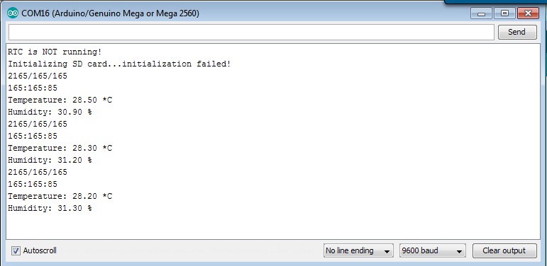

sd card to store temperature and humidity failed
hello
i work on this small project
DHT22 sensor (temperature and humidity) and SD card 16 GB to store the result
formatted with Fat 32
Arduino mega
i got this error message
the code is

loggingTemperature();
delay(5000);
below link of data logger Shield
print screen of problem
