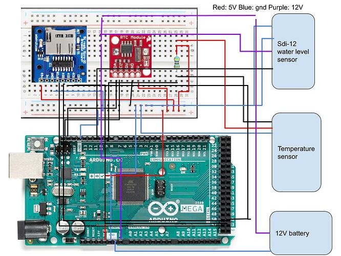

Hi! I have an issue with my SD Card that I just can't figure out. I have tried this code with an arduino mega and leonardo and they both have stopped uploading data to the SD card after an hour or two when the computer is unplugged from the device. The board is connected to a 5V ready mico-sd breakout board, a sparkfun rtc module, an sdi12 sensor, and a digital temperature sensor. I have tried using the SD card library and have tried to change everything I can from strings to char but the sdi12 sensor requires some things in String format. Let me know if you have any idea what could be wrong.

Monitor the time-to-sleep for a pattern (or none).
Does it always crash at the same point - the same number of records saved?
If you mean that this does not happen when your circuit is powered from the computer via USB, then I would suspect it is a power problem. Can you post a diagram showing how everything is powered? If you are powering the Arduinos with a higher voltage at Vin, then powering the peripherals from the 5V pin, then the onboard 5V regulators may be overheating. If you power from USB, those regulators aren't used.
It crashes at different points each time and from what I can tell there isn't a pattern. The SRAM availability stays constant for the whole program and it doesn't stop outputting sensor values it just stops. It also seems like the arduino continues running the code since I connected it to an LED that lights up when it is gathering measurements and that continues running over night even if the SD logging stops short. Also, the last couple tests have crashed after 166 measurements, 150 measurements, 130 measurements, and 123 measurements. I am powering the arduino with a 12V battery and am currently running a test with it connected to the usb to see if it logs more data to the SD card so will let you know how that goes. I have attached a circuit diagram but let me know if there is anything unclear.
So I did the test connected to the USB and it stopped after 151 entries again. Since I had the serial monitor up, I checked after and there were still values being written to the serial monitor but not the SD card once it stopped.
Ok, I think that settles the power issue. Sorry, but I have nothing else to suggest.
The String class might be causing memory fragmentation and eventual heap overflow = crash.
If it is causing this wouldn't the SRAM available be decreasing? I currently have a function running that tells me the amount of SRAM available which I thought would help give me a heads-up if the String class is causing overflow. Let me know your thoughts.
Is that SDI-12 - Arduino Reference (and GitHub - EnviroDIY/Arduino-SDI-12: An Arduino library for SDI-12 communication with a wide variety of environmental sensors. This library provides a general software solution, without requiring any additional hardware.) ?
Which things?
sendCommand has a cString alternative void sendCommand(const char* cmd, int8_t extraWakeTime = SDI12_WAKE_DELAY).
You have at least one bug in your code; if you set the warning level to all, you will be able to find it.
When you call String getsdi(char i, String meas_type, char sdiResponse, uint8_t cmd_number) { you pass it a pointer to an array instead of a character in this line (String temp0 = getsdi(addr, commands[a], sdiResponse, 0);).
The assocciated warning is
C:\Users\sterretje\AppData\Local\Temp\arduino_modified_sketch_182995\sketch_jul25a.ino: In function 'void loop()':
C:\Users\sterretje\AppData\Local\Temp\arduino_modified_sketch_182995\sketch_jul25a.ino:345:66: warning: invalid conversion from 'char*' to 'char' [-fpermissive]
You will also get an other related warning
C:\Users\sterretje\AppData\Local\Temp\arduino_modified_sketch_182995\sketch_jul25a.ino: In function 'String getsdi(char, String, char, uint8_t)':
C:\Users\sterretje\AppData\Local\Temp\arduino_modified_sketch_182995\sketch_jul25a.ino:135:49: warning: invalid conversion from 'char' to 'char*' [-fpermissive]
