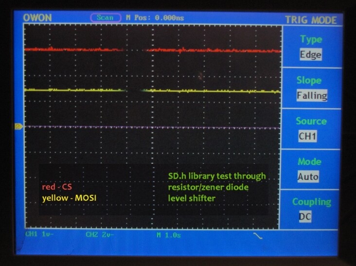

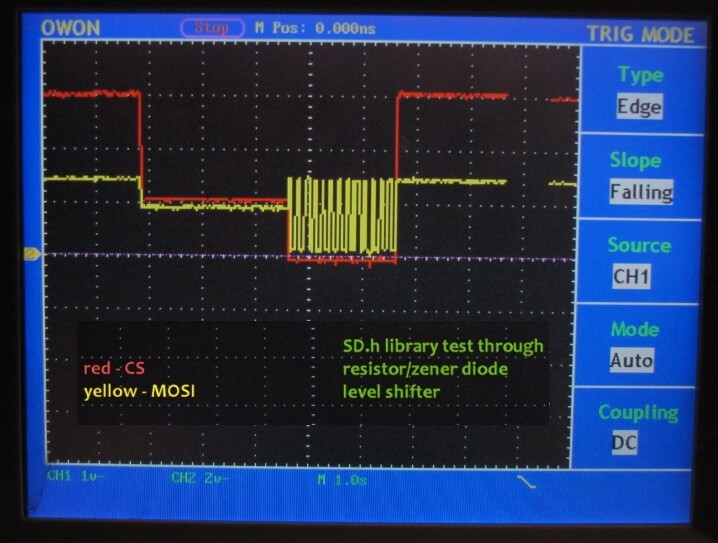

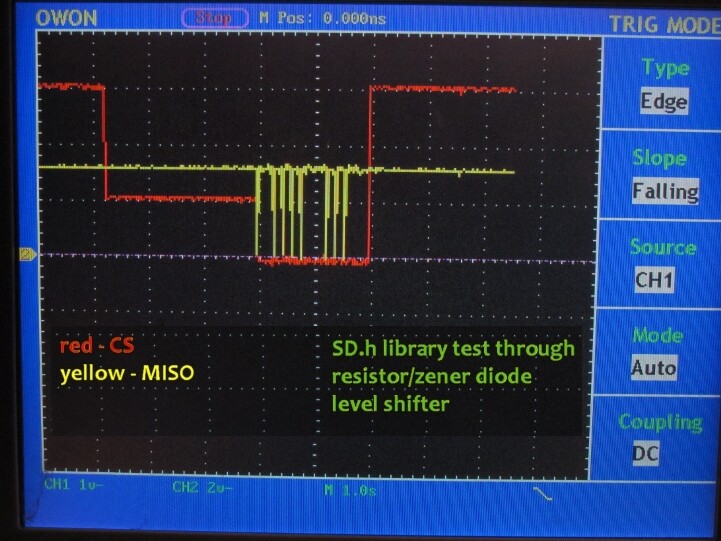

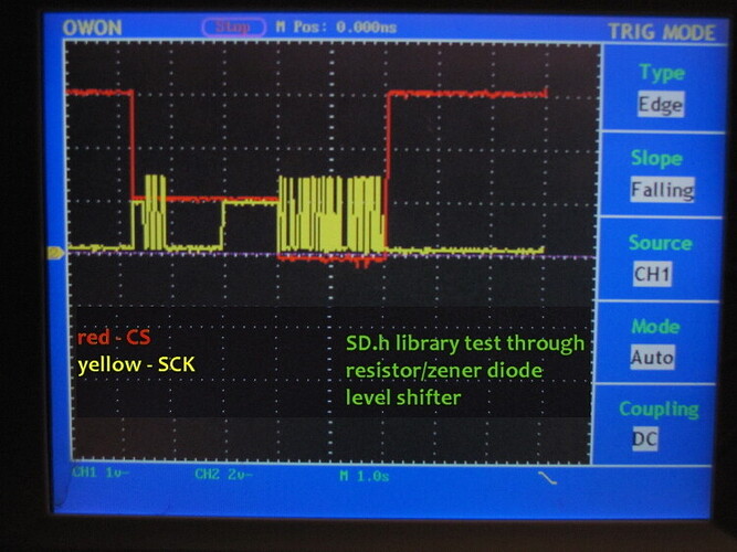

as you can see on the scope screen shots the voltages on the MOSI, MISO and SCK lines are wrong, the CS is ok.
I've tried other diodes and resistors and it's the same thing. Am I overlooking something?
Maybe 1Kohm on R1 is too much resistance? Try 220 ohms instead. If your o-scope lead is connected to the 3.3v input of the SD card, it appears you are not getting sufficient voltage on the 3.3v side.
edit: Insure the zener diode is connected correctly! If connected backwards, it will cause a similar voltage pattern.
I found a cd4050 buffer chip, hooked it up and it works. I connected the MISO line directly from the SD module to the Arudino pin. My resistor/zener diode method probably did not work because I used a level shifter on the MISO line, I'll have to do a test.
Stick with the 4050. It is a better solution.
