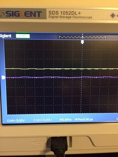

Any thoughts to why I had no SCL signal on the A5 pin?
like I mentioned earlier.... the O-scope didn't show any type of square wave. It stayed high.
or will this issue be corrected with the new library?
Well you should see something if you have the right pin and it has not previously been damaged. Swapping them over will cause no harm. You do need a pull up resistor on each line of 4K7 but that would not stop you seeing a signal.
Is it a dual trace scope? If so trigger on the clock and look at the data.

yes it has dual trace.... I'm using a 5.1k resistors, I'm all out of 4.7k.
I checked the SDA and SCL again. I looks to have some noise that is consistent with "normal operation"
however, the SDA is around 0 and SCL is around 5 on the voltage scale.
There is no definite 5 to 0 jumps on either line showing that 5v is being pulled low as it should be.
perhaps I have a short to ground on the SDA??
pic of Oscope. Yellow is clock purple is data
Well given that you said:-
That might be a short to the supply.
Load a blink sketch and see if that pin can toggle up and down.
By the way I can't see anything on either of those lines that looks like a clock.
When the bus is idle (like most of the time, as you won't be sending data) the lines are kept high. So that explains why you don't see anything.
No need to mess around with a scope. Run an I2C scanner. That'll keep the bus pretty busy, and the moment it returns the address of your display you also know you have the wiring correct. Note that some displays are at 0x27, others at 0x3F. Yours may have yet another address, the I2C scanner will tell.
Or install the hd44780 library and run the diagnostic sketch. Post the results. The hd44780 diagnostic will have more information than running the scanner sketch.
Just for everybody who had input on this topic.
I used another proMini and now it works.
I found two issues in my hardware.
A) I was using a 3.3 board and put 5 to the vcc
B) Solder issue on the data pin on the backpack
Thank you.
LandonW:
That will do it! :astonished:
I had attempted to pull out the header-pins with my iron and pliers. I had to turn my heat to max. I think the eyelet got pulled out and I didn't notice when I soldered a wire into that hole.
