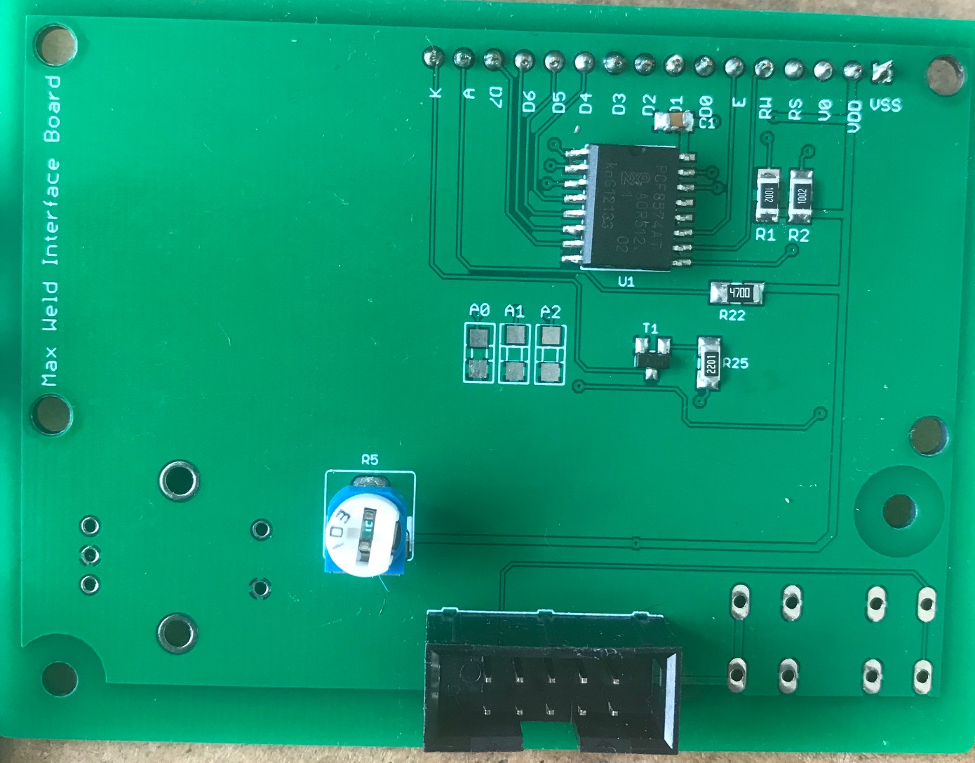

i am trying to troubleshoot my PCB which has 16x2 LCD on an i2c bus. Not very good at it.
Any help would be appreciated.
The code does work when I used a prebuilt one from eBay. I've replaced the I/O expander, the transistor and checked SDA and SCL for continuity, all looks good but still nothing seems to be working. The back light just blinks and goes OFF and the first row in the LCD just shows thick blocks leaving the second row blank.My I/O expander reads as PCF8547AT.

Does the I2C expander (PCF8574) show up in an I2C scanner?
The hd44780 library comes with a diagnostic sketch. It is in the examples for the hd44789I2Cexp ioclass examples. Load and run that sketch and post the results.
Here is the output

Checking for required external I2C pull-up on SDA - YES
Checking for required external I2C pull-up on SCL - STUCK LOW
Checking for I2C pins shorted together - Shorted
ERROR: SDA and SCL shorted together
I2C bus not usable
Not sure why the SCL lines reads low at boot up. When i reset manually via the reset button it reads HIGH on both pins.

Can you post some photos of your board?

here power the main PCB and then connect the LCD and it shows SDA and SCL are pulled up
Serial Initialized
I2CexpDiag - i2c LCD i/o expander backpack diagnostic tool
hd44780 lib version: 1.0.1
Reported Arduino Revision: 1.8.5
CPU ARCH: AVR - F_CPU: 16000000
SDA digital pin: 18 A4
SCL digital pin: 19 A5
Checking for required external I2C pull-up on SCL - YES
Checking for I2C pins shorted together - Not Shorted
Scanning i2c bus for devices..
i2c device found at address 0x20
i2c device found at address 0x24
Total I2C devices found: 2
Scanning i2c bus for all lcd displays
No working LCD devices
Now i leave the LCD connected and reset the board and i get SCL - Stuck LOW

The questions becomes why is the SCL pin (Arduino digital pin 19) reading as low when the Internal AVR pullup is enabled?
I also can't figure out why two i2c slaves show up at addresses 0x20 and 0x24 (from post 11)
What voltage do you see on the SCL / Arduino digital pin 19?
--- bill
SCL reads 0.020v with the LCD connected and 5.0v when disconnected. Could it be because the traces are not far enough from each other or could there be some interference.

That is a problem.
It kind of looks like something is shorted like maybe a bad trace or perhaps something is not connected properly to create a short.
Look closely at the traces that go between the PCF8574 SCL pin 14 through the resistor as it connects to VCC.
