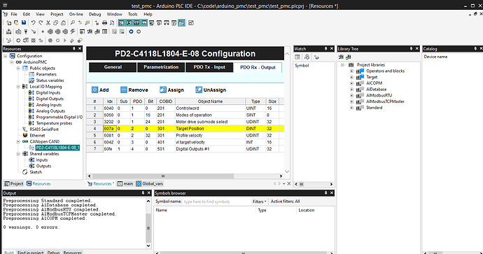

I am working on a project where I am trying to use the Arduino Portenta Machine Control (PMC) to communicate with a Smart Stepper Servo from the company Nanotec (PD2-C).
I got the EDS file from the company, and I managed to set up the CAN bus in the resources tab (I think) and import the device from the EDS.
Now, as I am completely new to PLCs, Arduino PLC IDE and using CANopen, I don't really know how to continue from here.
What I do know is that:
  • I want to command the servo motor to move to a new position
  • I can do that by sending the Target Position command highlighted in the below screenshot
  • I assume that I must start the CANopen bus and its connected devices somewhere in the code
  • I assume that I must write a piece of code somewhere to execute the PDO command being sent, (for example once a second with an incrementing position target)
  • I assume I do this with a Function Block? Not so familiar with the terms here, so this is a bit of a guess.
I have not been able to find any beginners tutorials on using CANopen in PLC IDE with PMC, except for setting up the bus.
I would really appreciate it if anyone has any links to tutorials for using a CANopen device with Arduino PMC, and how to set that up in PLC IDE.
Would also be thankful for tutorials in other IDEs that might shed light on how you "execute a device PDO" with a PLC. How do you code that.
An example could be reading the temperature value from a CANopen enabled digital thermometer, for example.

Hello,
I'm also trying to get the CANopen to work within the PLC IDE enviroment. I've looked through all of the links that were posted here. Thank you for those.
within the Library Tree (Project Libraries / AICOPM) i found some of the functions and status structs which i assume are used by the CANopen stack according to their description.
On the oscilloscope i can detect the bootmessage from both the master and slave. So i assume the CANbus is setup properly.
I tried calling the functions within the code directly eg. with the sysCopm_SlaveGetObjInteger function i found in the library tree
sysCopm_SlaveGetObjInteger_Inst1(
	can := COPM_CHN_CAN0,
	node := 7,
	obji := 16#2201,
	objs := 1,
	tmo := 1000,
	val => UserPara1
The status and error flag of the function say COPM_E_CFG_SLAVE_NOT_EXISTS "Slave does not exists in netlist"
But no matter what i tried the bus remains at idle after the initial boot message. From the status struct sysCopmStatus i can see the status of the master is COPM_STATE_NOT_KNOWN.
The only function i got to achieve a result is the
sysCopm_Reboot(can := COPM_CHN_CAN0);
which restarts the CANopen master and i can see the boot messages on the scope.
Did anyone get the CANopen master working? Maybe atleast the infos here help someone further.

Hi all,
for all the CANOpen tasks with the PLC IDE, the reference documentation is here Configuration: CANopen - Axel Public Wiki.
As long as you have the Catalog for your device, you just have to import it and the PLC IDE will take care of configuring everything and making all the resources available as shared variables as usual.
Bests,
Giampaolo
Hi Giampaolo
Thanks for the wiki link.
I set up a completly new project with all the infos form the wiki and still do get the same error behavior.
A bootmessage is sent by the master and slave after booting. Then the bus goes silent.
In the sysCopmStatus I can see the status fo the CANopen master is COPM_STATE_NOT_KNOW - Unknown, not present
Do you have any more ideas?
