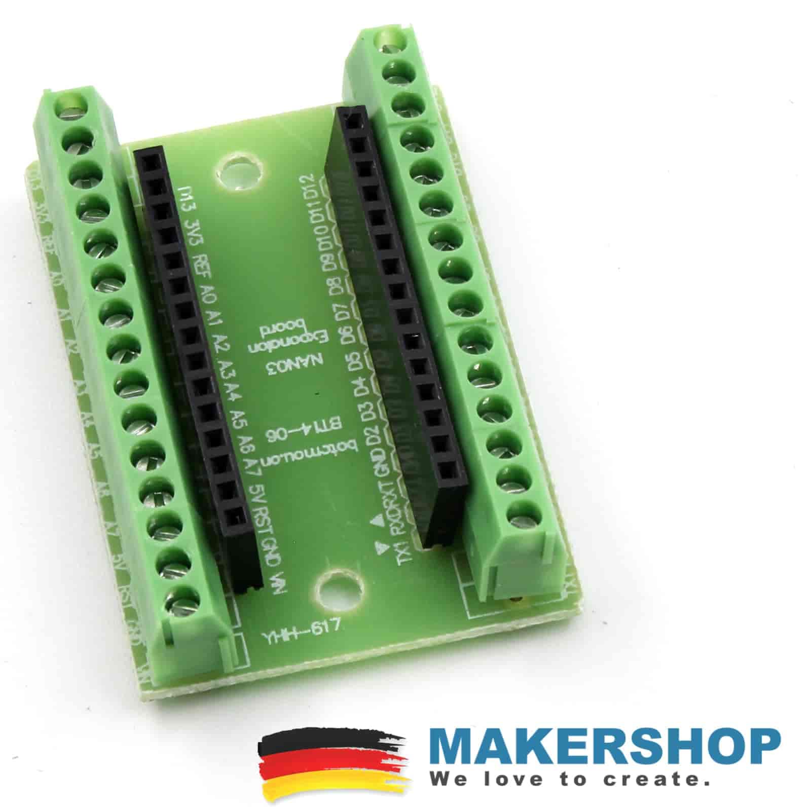

May you can use this type of breakout prototype proto shield in a small case for yours project.
That - as marked - is for the Nano which is far more appropriate for any project unless you have a UNO "shield" which plugs in and performs all the interfacing you need.
