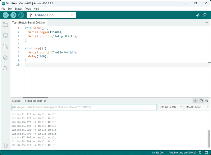

Seeing / copying more lines in the serial monitor by showing the monitor on the right

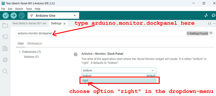

Here is a screenshot for screenshot tutorial that shows how you can configure IDE 2.X to have the serial monitor not at the bottom of the window but on the right side.
If you have installed IDE 2.X and show the serial monitor it looks like this

IDE 2.X								| IDE 1.8.19
integrated part of the main window  | extra and resizable window
See many lines of code and          | see many lines of code AND
a few lines of the serial monitor   | many lines of the serial monitor
or                                  | at the same time
See a few lines of code and         |
many lines of the serial monitor    |
you can copy only the visible part  | you can copy THOUSANDS of lines
of the window = 5 to 40 lines       | shown in the serial monitor

Thanks for the writeup.
I have been running my Serial monitor to the right for a while now, which helps.
One note, at least on my windows machine, I can simply press
the F1 key instead of having to remember ctrl+alt+p
