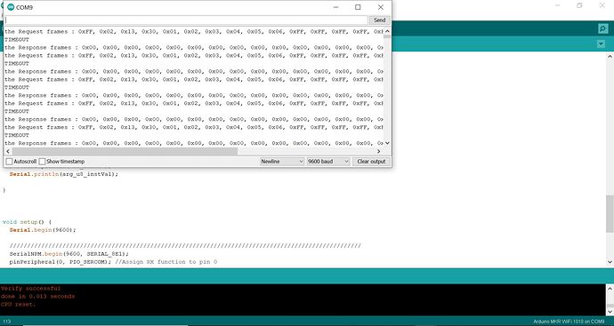

I'm working on a serial communication project with sensor cairsens. My code is based on the datasheet (in attachment page 9-10-11). But I didn't get a result from the sensor, I got Zero as response frame.
Here what I got in Serial Monitor:
the Request frames : 0xFF, 0x02, 0x13, 0x30, 0x01, 0x02, 0x03, 0x04, 0x05, 0x06, 0xFF, 0xFF, 0xFF, 0xFF, 0xFF, 0xFF, 0xFF, 0xFF, 0x12, 0xAF, 0x88, 0x03,
TIMEOUT
the Response frames : 0x00, 0x00, 0x00, 0x00, 0x00, 0x00, 0x00, 0x00, 0x00, 0x00, 0x00, 0x00, 0x00, 0x00, 0x00, 0x00, 0x00, 0x00, 0x00, 0x00, 0x00, 0x00, 0x00, 0x00, 0x00, 0
Firstly, I wrote the Request Frame in the array (requestvalFrame) and by SerialNPM.write I sent the request then I read the response by SerialNPM.readBytes (in array responseArray)when I will get the response of the sensor but I got Zero. (Using SerialNPM or Serial1 gives the same result)
Did I miss something? If you can help me I will appreciate that.
