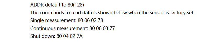

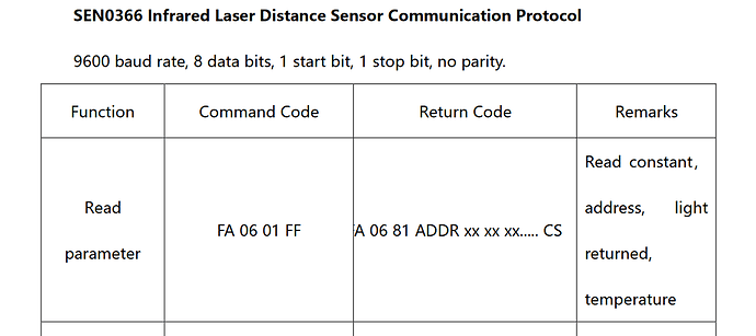

But there is also a communication protocol SEN0366 Communication Protocol.pdf avaiable, where I can change the setting of the SEN0366, like the frequency or the accuracy. But I don´t know how to put this into my code. Here is a snippet of this document:
Does anybody knows how to send the command Code to this Sensor. I have tried:
Serial1.println("FA 06 01 FF") ;
in my Code or I typed in this command into the console of the Arduino IDE, but nothing happens. I also don´t know how to recieve the return code.

For example, when I set resolution, then there should be a return code like in the third column of this snippet from the sensor communication protocol (FA 04 8C 76):
the console give me a "-1" for this code (line 17) in the setup()
if (mySerial.available()>0)
  Serial.print(mySerial.read());
