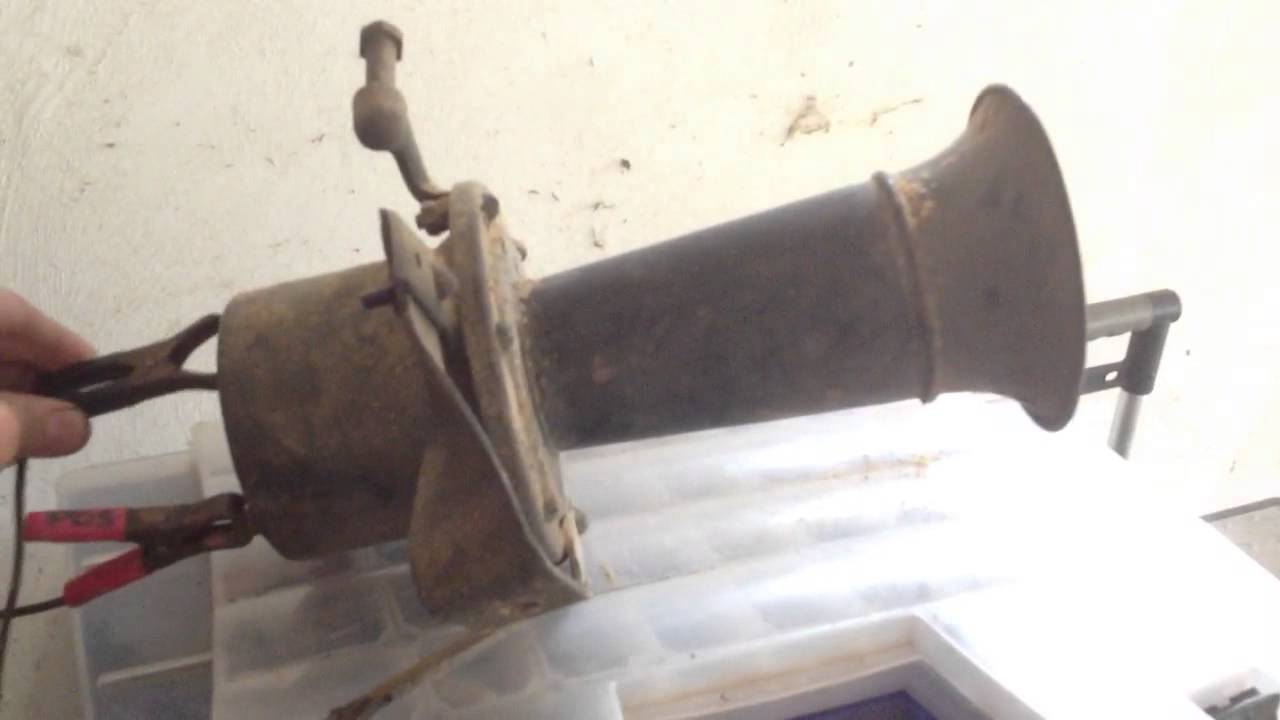

Secondly, the existing watch has the detection part well under control, as I understand from your post. Don't mess with that, I bet it's not trivial and easy to break, instead look at the alarm side: how to improve on the alarm, as that's what you're concerned about. That may be changes to the existing Android/iPhone app, or adding some noisy hardware or so.
As for hardware, I suggest you get one of these, if you can:
