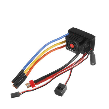

I found this esc
or this
I do not see connections for the sensors on either of those, so I suspect that they would drive the motor like a sensorless motor.
As I understand, sensorless has less low RPM abilities that seam to make balancing applications behave better.
Note that this observation about the preference for sensored motors is only based on reading. I have never made a balancing robot.
vinceherman:
In the description is write "sensored"

Without sensors you cannot hold the motor still with closed loop control, meaning essentially no position control,
cannot balance...
However if the motor controller can get information about the position from the encoder and
translate that to output phase, you get closed loop control back again. Since you have an encoder
or tilt sensor for balancing anyway this can be done but you have to be more into the details
of motor control, you have to understand phasing a 3-phase motor for instance.

You need an ESC capable of driving forwards and backwards. Something designed for this application and not an ESC intended for a quadcopter. Almost any land vehicle ESC is going to have this capability, except for bike/motorbike ones.
I'm not convinced that a sensored motor is essential. Gimbals work to hold position with simple 3-phase BLDC motors without sensors. They're basically being driven like stepper motors with an extremely high microstepping ratio. They jerk when they switch on. I don't know if this is a problem for a balancing bot. If you must avoid the jerk, then there's no alternative to using a sensored motor and controller.
