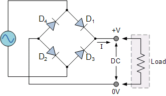

Yes, 4 diodes . You are correct. I forgot that.
It's actually a full wave bridge rotated 90 degrees CCW with the AC connections on the left and right instead of the top and bottom. You can actually use a full wave bridge module if you have one, by replacing the AC source with a motor. You can see both the motor in the first circuit and AC source in the second circuit are connected to the same nodes.
Take the diodes in the H-bridge circuit and redraw it with one connection node at the Vcc end and the GND
end and it is the same as the bridge rectifier in the other circuit , only rotated CCW 90 degrees.
You need one diode across each switching device, be it BJT or mosfet.
raschemmel:
That is an excellent insight! I didn't notice at first. I only thought of them as flyback diodes.

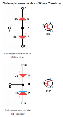

Version 2 - attempt failed 2 :slight_smile:
So, I thought, I'd go ahead and make a variant using only NPN transistors. The simulation can be found here: EveryCircuit - HBridge NPN - Linked
Diagram attached.
While it works in the simation, I've thought of a couple of problems why this design wouldn't work well:
  • Still no flyback diodes
  • Even if there were, there would be problem with the circuit because there is no path for current to flow after switching off both switches

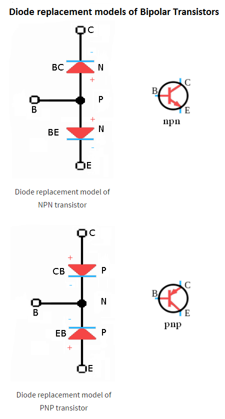

Please make not of the difference of BJT diode models from above link/image.
With NPNs, after the motor has ran for a while, and I switch off both switches, there is nothing that would "soak up" the electric field in the inductors or path to ground. I'm guessing component damage? (Obviously I don't know, I'm not an electrician, just learning)
With PNP, there is always a path from the motor to ground in the first, PNP based circuit.
I could expand the NPN based circuit with a NAND gate that would open when neither switch is on to create a path to ground. That could potentially solve that problem with 2 extra transistors.
