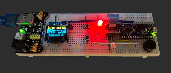

Schematics (directly connecting LED to Arduino pin):
Actual connection:

Show us a good image of your ‘actual’ wiring.

Thanks for the suggestion! I've added those to the main post.

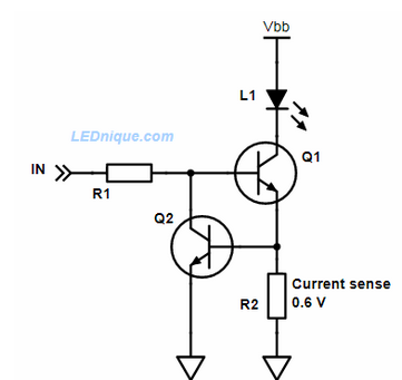

You may want to consider a constant current drive:
Ref.
As Wawa said, you can put LEDs and their drive in parallel - more current of course. Two LEDs in series with ~300mA current may be less strain on your power supply.
If you have a greater voltage power supply, than your 5V, this circuit will allow multiple LEDs in series. If, say, a 12V supply then you could have many series.
