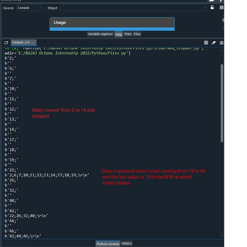

I want to control my stepper motor RPM using a scale/slider widget in tkinter (Python). But while sending the data the data is received late
i.e. I move the slider from x-->y stop there and then move from y-->z stop there. My motor rotates at :
x RPM when my slider stops at y
y RPM when my slider stops at z
and so on

I guess that the semicolon shall be used as EOM. If the Arduino does not know that then it may wait for a timeout instead.
I looked at this and though the "command" in the scale is perhaps a good way to go I decided to try displaying the scale values in a separate thread, this does not stop you from modifying things a little to include the "speed" method. I also agreed with DrDiettrich and replaced the semi colon with a newline character.
The thread is designed to display the most recent value once only and the "sleep" is only there to remove a little jitter so can be commented out if you want.
Actually the test code resembles something I posted yesterday with the Arduino echoing back the resulting value.
