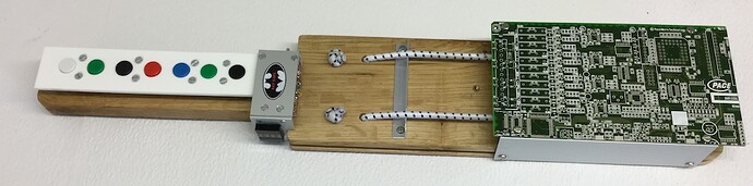

There are many types, some whit built in electronics. I made a bass guitar out of bungee chord and used this method, but I only used two strings.
I also make instruments for disabled people and I think you are better off making the whole thing rather than trying to modify an existing instrument, especially with your quite frankly paranoid safety restraints.
Here is one I made earlier

This is a picture of my Bat Bass with opto sensors.
IMG_2782

It is a simple digitalRead to see if the sensor is blocked or not. Normally the string would not block the beam. When you see it block the beam you would send a note on MIDI message. Then you keep monitoring the sensor and when it has been found to be off for a certain time you send the note off message. The "certain time" is up to you to determine by experiment but it is not very critical.
The difficulty you will have is that a 2mm string might not be enough to block an opto slot sensor beam, but it will reduce the overall strength of the beam. In which case you might require some simple external circuit that detects an analogue level from the sensor. This circuit is called a comparator, and you normally get four of them in a single IC package. A poplar one is an LM339.
