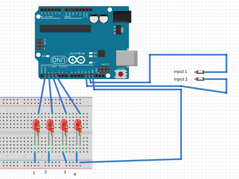

Ive been asked by a friend who works with children if i could help with an idea they had.
I dont understand all of it (lots of things to do with kids growing up and learning) the basics are she would like what is basically a light (or any other physical display) board that changes in different ways when the inputs are pressed.
Ive done a stupidly simple design on fritzing and explained it to her and she thinks it will work. Basically when the input switches are pressed it changes which LED is lit up, turning all the others off.
Input 1 is up in number.
Input 2 is down in number.
For each time input 1 is pushed it effectively adds one to the count of LED, so press it 3 times and in sequence the LEDss will light up until number 3 is on.
use input 2 and it will subtract 1 from the count. So if were at input 3 and press it twice the input 1 will light up.
The idea is to have different color lights, ie a red, green, yellow, blue or in the future have things other than just LEDs. such as a spinning wheel a led chaser and things like that.

Don't use pin 1 as an output pin for a LED - it is also the TX pin, and either function could interfere with the other. Your push buttons are not operational. They have only a pin connection, but nothing on the other side of the switch. I would suggest grounding the other contact.
Then take a look at the Examples menu, particularly Button and DigitalInputPullup. Work with the code in those examples to build your program. Come back when you hit a wall, and folks here will help you over it.
ok ive changed a few things.
and have a code that might work, can someone read over it?
Im waiting for another UNO to arrive to test it.
