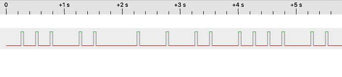

For what passes as fun in my empty life I used a logic analyser to record the output of the sketch.
Looks like 1, 1, 1, 0, 1, 1, 0, 0, 1, 0, 1, 0, 1, 1, 0, 1...
Pulses are on a ~250 millisecond grid and measure ~50 milliseconds.

Hi All,
sorry for the late reply !
Well, effectively my code work well !
My mistake, which i'm confused why, but it work fine like this, it's that what I write LOW have to be HIGH and what is HIGH have to be LOW !
With that way the result is what I expected...
thanks
Florent
The only appearances in your sketch of HIGH and LOW are around turning an LED on and off.
How did you wire the LED, and do,you have a series current-limiting resistor also?
LEDs can be wired so LOW lights them up, they can be wired so HIGH lights them up.
