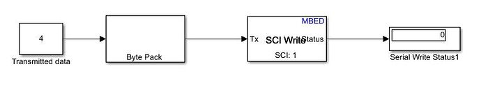

I am trying to send a uint16 value(converted to 2 bytes) from a STM32 board through Simulink using serial communication to a STM32 board programmed with Arduino IDE. At first, I was able to read the values being sent after being decoded, but after that the values are a mess. I was wondering if there are ways to help the board read the right bytes in the right order. I have read the Serial Input Basic, but with example 4, it uses a "\n" end marker, which is not possible in my case. I would greatly appreciate it if anyone could suggest a solution to this.
Arduino code:

can you send the number in ASCII decimal representation and add the trailing line feed ?
then you don't have to worry wether it's a 2 or 4 byte integer, little or big endian etc and you have an end marker to get in sync with the sender
you really need to encapsulate raw data in a message packet with a well know start and end in order to remain synchronized with the sender.
as @J-M-L suggests, sending data as ASCII strings, which require more bytes avoids this headache
SoftwareSerial at 115200 baud probably won't work. Use a hardware serial interface if you need that speed.
I'm sure the order is correct but you probably miss some bits or even bytes with your setup.
Do you tell us the reason? You might have to forget the binary transfer but ASCII transfers are easier to control anyway.

That only works if all systems have the same "endianness". If you send 0xAA, 0x55 to a Little-Endian processor you will get a value of 0x55AA. If you send it to a BigEndian processor you will get 0xAA55.
not to mention that it's undefined behaviour to use union this way (write a member, read from the other)
But it works on all compilers I'm aware of. Do you know any exception?
I think I can send the number in ASCII. I can convert it to string then convert it to ASCII, but I'm not sure if it's right, because there are no integer to ascii block. Unlike Arduino's Serial Transmit Block in Simulink, STM32's SCI Write block has no option to add trailing line feed. So I don't know how to add it yet.
it works indeed but yet in some cases it can fail (compiler adds padding etc). So best not to use it and do it the proper way with memcpy() and the compiler will do the right thing.
