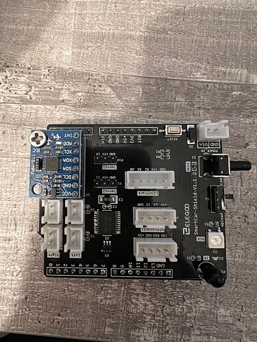

And here is how I connected the two of them:
Thank you. So, when I was using the shield it was working (I mean with the original manufacturer program - which is Elegoo) - this mean in this case that the level shifter was included in the shield?
Here the picture:
Thanks
please provide a link to the shield.

the shield is a 5V shield and does not need a level shifter to talk to the Uno which is also a 5V device.
One cannot use the Uno's pin-0 and pin-1 for serial comms. One will need software serial on the Uno and the buad rate will be 9600.
The Uno will NOT adequately power the ESP32 cam.
