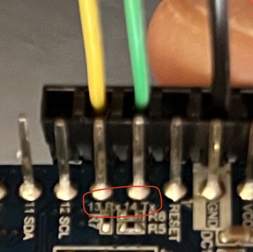

Hi, I would like to do hardware serial communication between the Nano 33 BLE and OpenRB-150 which is very similar to an MKR board. I'll show what I have - but it's not working:
Here's the connected pins from the nano to the OpenRB-150:
- TX1 -> 13 Rx
- RX0 -> 14 Tx
- VIN -> 5v
- GND -> GND
I am trying to power the nano from the openRB-150, which works and I can run codes on the boards separately while the openRB-150 powers the nano. I want to use Serial2 for something else on the OpenRB-150 and want to use pins 13/14 to talk with the nano.
