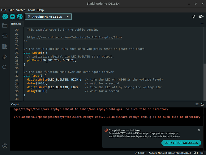

Hey @KurtE,Thank you for the brief explanation; I really appreciate your time.
Current Situation:
I understand a few things after burning the bootloader by selecting the programmer as shown in the screenshot below:
Bootloader ProgrammerFollowing your instructions and referring to the Arduino Core Zephyr GitHub page, I put my Nano board into bootloader mode. However, when I attempted to upload a basic application from the Arduino IDE, I encountered the following error:Upload Error
Request for Guidance
It seems I might be uploading the Zephyr application incorrectly. Could you guide me on where I should build my application and how to upload it?
System Information:
  • OS: Linux Ubuntu 24
  • Arduino IDE Version: 2.3.4
  • Zephyr SDK: Installed as instructed
If you suggest trying a different platform, I'm open to that as well. My goal is to run the "Hello World" Zephyr application on the Arduino Nano BLE 33 Sense Rev2 board and view the serial output using the command or any other way:
sudo screen /dev/ttyACM0 115200
Currently, I can't see the serial output because of disconnection issues after uploading the Zephyr application as i mentioned before.

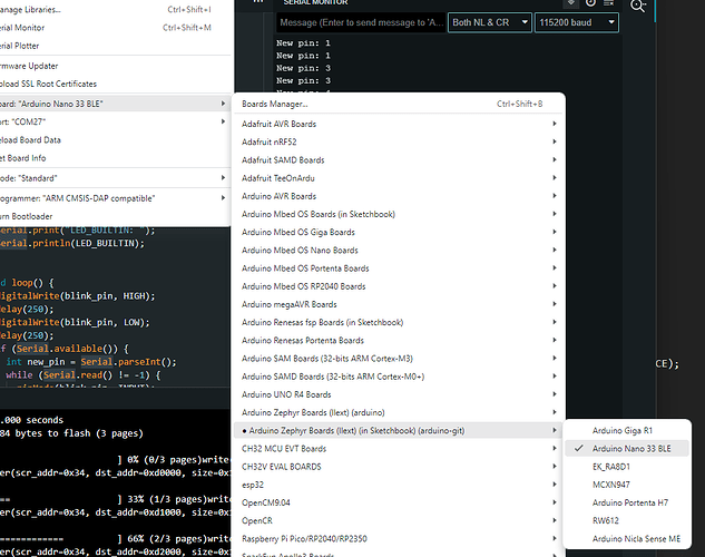

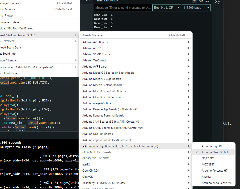

Think the readme for the installation of zephyr is pretty straight forward:
Installation
Install the core and its toolchains via Board Manager:
  • Download and install the latest Arduino IDE (only versions 2.x.x are supported).
  • Open the 'Settings / Preferences' window.
  • Open the 'Boards Manager' from the side menu and search for 'Zephyr'.
    • If it doesn’t appear, add the following URL to the 'Additional Boards Manager URLs' field: https://downloads.arduino.cc/packages/package_zephyr_index.json (if you have multiple URLs, separate them with a comma).
  • Install the Arduino Zephyr Boards platform.
Alternatively, to install the core using the command line, run the following command with the Arduino CLI:
arduino-cli core install arduino:zephyr --additional-urls https://downloads.arduino.cc/packages/package_zephyr_index.json
:building_construction: First Use
To get started with your board:
  • Put the board in bootloader mode by double-clicking the RESET button.
  • Run the Burn Bootloader option from the IDE/CLI.
    • Note that due to limitations in the Arduino IDE, you may need to select any programmer from the Programmers menu.
  • Once the bootloader is installed, you can load your first sketch by placing the board into bootloader mode again.
Note
After the initial setup, future sketches will be loaded automatically without needing to reset the board.

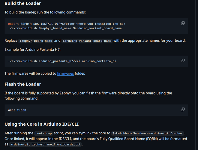

So i couldnt upload the loader as they mentioned in the steps:

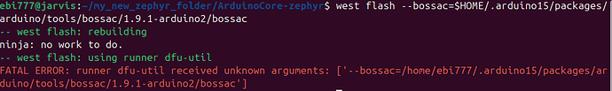

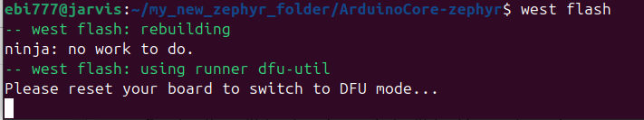

i am using the below command:
ebi777@jarvis:~/my_new_zephyr_folder/ArduinoCore-zephyr$ ./extra/build.sh $arduino_nano_33_ble_sense
in this image untill build the loader its happening,
but when i try to flash it stuck in here:
but after that i tried with the bossac also, again some error:
then i tried to add the overlay and config file that they gave it inside the loader file in vs code zephyr environment, then also same error i am getting.
