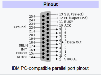

If the scale has a 25 pin serial port then it is almost certainly using RS232 for its serial connection. This is completely incompatible with the TTL voltage levels provided by the Arduino.
You need an RS232 to TTL converter between the 2 devices

Remember RS323 is a bit picky in that Tx expects a listner Rx and Rx expects a tallker Tx. There are other pins as well such as CTS, DTR, etc. No idea if they were used. Over the years I have seen several combinations. You can get the service manual from: A&d GF-300 Manuals | ManualsLib That should tell you.
As I remember the 25 pin port is a parallel "centronics" type port. As described by IEEE1284
The fun begins here --
Rs-232C Serial Interface / External Input - A&D GF-1200 Instruction Manual [Page 59] | ManualsLib
Legacy it is (and that's OK).
I have the connections right, I believe this is RS232C and the voltages are too high for my Arduino UNO. I was using a PB on the breadboard for print and Re-zero. The re-zero works, and I believe the print button is working, but I can't get anything ot print. I changed the Rx, Tx, to pins 10,11 and wired them for Rx to Tx and vice versa. Still nothing. I do not have a TTL convertor. If I understand correctly, I need the convertor to lower the voltage level. I am a bit lost, but will keep researching.

Whilst there were large Centronics parallel printer ports there were also 2 flavours of serial ports, one with 9 pins and one with 25 pins so all bets are off

Can you please post a clear picture of the "printer" port of the scale ?
I ahave connected Scale Pin1, or Frame ground, to the ground on the UNO. RX, or Pin 2, is connected to Arduion DO9,the designated UNO TX pin. The Scale TX, or Pin 3, is connected to Arduino DO8, the designated RX Pin. I have wired the Scale pins 18 and 19 to the signal ground pin through pushbuttons. The reset works fine. I am not getting anything at all when I hit print. I have put the diodes and resistors in place to reduce the voltage coming in to the arduino.

You should use pin 7, signal ground (SG). Frame ground is the electrical ground connections used for any shielding around the cable.
Yes, I am working on that now. My program won't read the "inverse_logic" command for some reason. Thanks for the tip. I will get in in.
Thanks. Yes, I have the signal ground, pin 7, connected to the Arduino ground.
