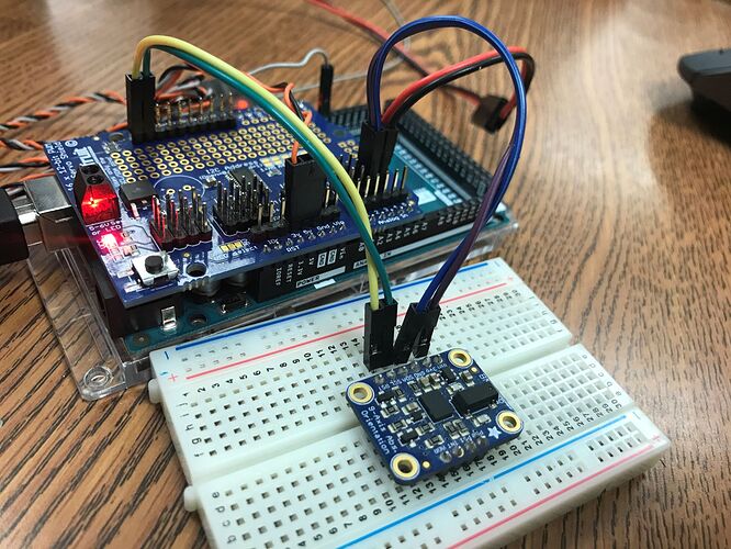

OP image:
errors appear when power is applied to the IMU even when the code is commented out
Shouldn't you stop right there, and look at hardware issues first? In the image, I see no 3.3V-5V level translation. It's hard to troubleshoot any more visually because I'm not familiar with that shield.
I haven't pursued hardware very close, because if I do every element individually they each work. Serial read works on its own and and the IMU works on its own with the same circuit. Only if I try to do both at the simultaneously do I get the issue.

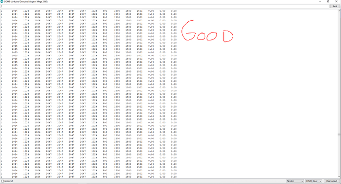

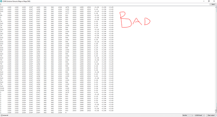

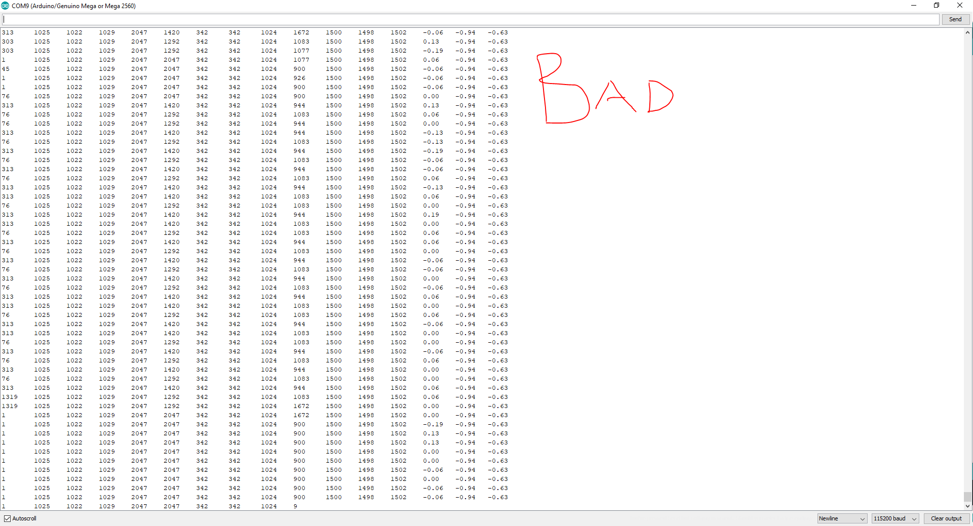

I have attached a screen shot of each "good" and "bad" data streams. The good data is vary constant (columns 1-9) and predictable as I change the controller position. The bad/erratic data all comes through; though, is constantly changing and each channel appears to affect multiple outputs rather than its single channel.

Do you power the IMU from the servo supply pin? (power from the screw terminal)
Shouldn't you connect IMU SDA/SCL/power directly to the Mega instead of running it over that servo board.
SDA = pin20
SCL = pin21
5volt (end of the double row, near pin21) to V-in of the IMU
ground (end of the double row, near pin15).
Leo..
Edit: Adafruit boards have AFAIK always I2C level translation buildin.

Columns 1-9 (starting from the left) are the streams from the RC receiver serial and should be 0-2048. These values is where my issue lays.
While the serial data read is working standalone the values (1-9) are consistent over time with a constant input on the RC transmitter. When I bring the serial read and the IMU read together those values become very noisy. Interestingly the IMU data the 3 most right columns are very consistent and appear to be correct and smooth as I move the sensor.

In the attached photo I am powering the IMU from the 5V servo rail on the middle of the shield, with the SCL/SDA going straight to the MEGA. The jumpers just happen to be going through the pins raised on the shield.
I suggest to remove the servo shield and all the program calls that instance the servo library, set pwm, etc.
Connect the radio and the BNO055 directly to the mega and test that combination.
Elijahl:
Don't.
Servo power (middle pins) comes from the screw connector, and has nothing to do with the Mega itself.
