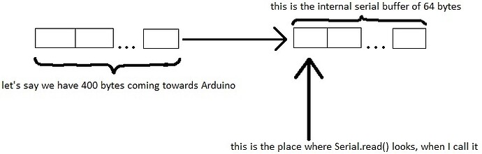

Let's suppose we have this case:
If my loop() function takes 2 seconds to be executed once, then all I read from the internal serial buffer, is the last byte entered. All the other bytes are gone. Ok, let's say I can read all the buffer, but there are still 400-64=336 bytes gone forever. And if I increase the baud rate, then everything gets worse, because that means I have to reduce somehow the time consumed by loop() in one execution.
It's clear, then, that loop() should not take 2 seconds to complete. What does it? If there are any delay() calls, get rid of them.
So, from my point of view, there is an inconsistency between the serial speed and the loop() execution speed.
The loop() function should not take anywhere near that long. The loop() function should iterate several times per millisecond. Each byte of serial data takes several microseconds to arrive, so reading all that have arrived during an iteration of loop() should, assuming loop() is called often enough, prevent overflow of the serial buffer.

Those 2 seconds were an hypothetic case, to underline a principle and, with your help, to see if I am right.
So thanks! All the answers were helpful.
But in your last answer, if a byte needs, let's say 10 microseconds, to arrive (of course, it depends on the speed and on the number of errors occured, but let's say we don't have any errors now), and the loop()is executed in 0.1 miliseconds, there would still be an inconsistency. Some bytes will not be read by the Serial.read().

In the first case, how can i know y don't gets the same byte like x did? - because the speed of calling two consecutive Serial.read() could be greater than the speed of serial transmission.
The read() method removes the byte from the buffer. Calling the method pop() would have been a better choice, in my opinion.
Neither example is any good. There is a method, available(), that indicates how many bytes there are to read. Don't read more than are available.
...something time consuming...
Doesn't belong in loop. Restructure the code to be non-blocking. Or, forget speed and deal with lost serial data. Your choice.
Now it makes sense. I didn't know that Serial.read() deletes the byte from the buffer after reading it. There's no such thing in the Reference page.
