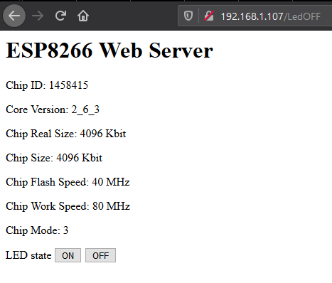

I tested this code, and it worked

Now, I would like to understand how do I connect an LED to an Arduino Mega digital port, and not directly on the ESP GPIO0
How to work with the two together?
