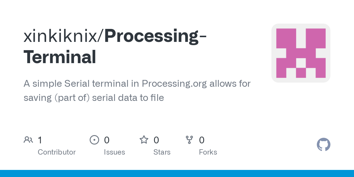

I wrote my own monitor solution :slight_smile:
Here is the code:
  Serial.begin(115200);// put your setup code here, to run once:
  float temp = random(18,22)*1.0;
  Serial.printf("Temp: %.2f°C\n",temp);
Here the output:
OK, well maybe when you find the bug in your terminal if will give you a clue about what the bug is in the Arduino IDE 2.x Serial Monitor. If so, please leave a comment here or on that bug report.
