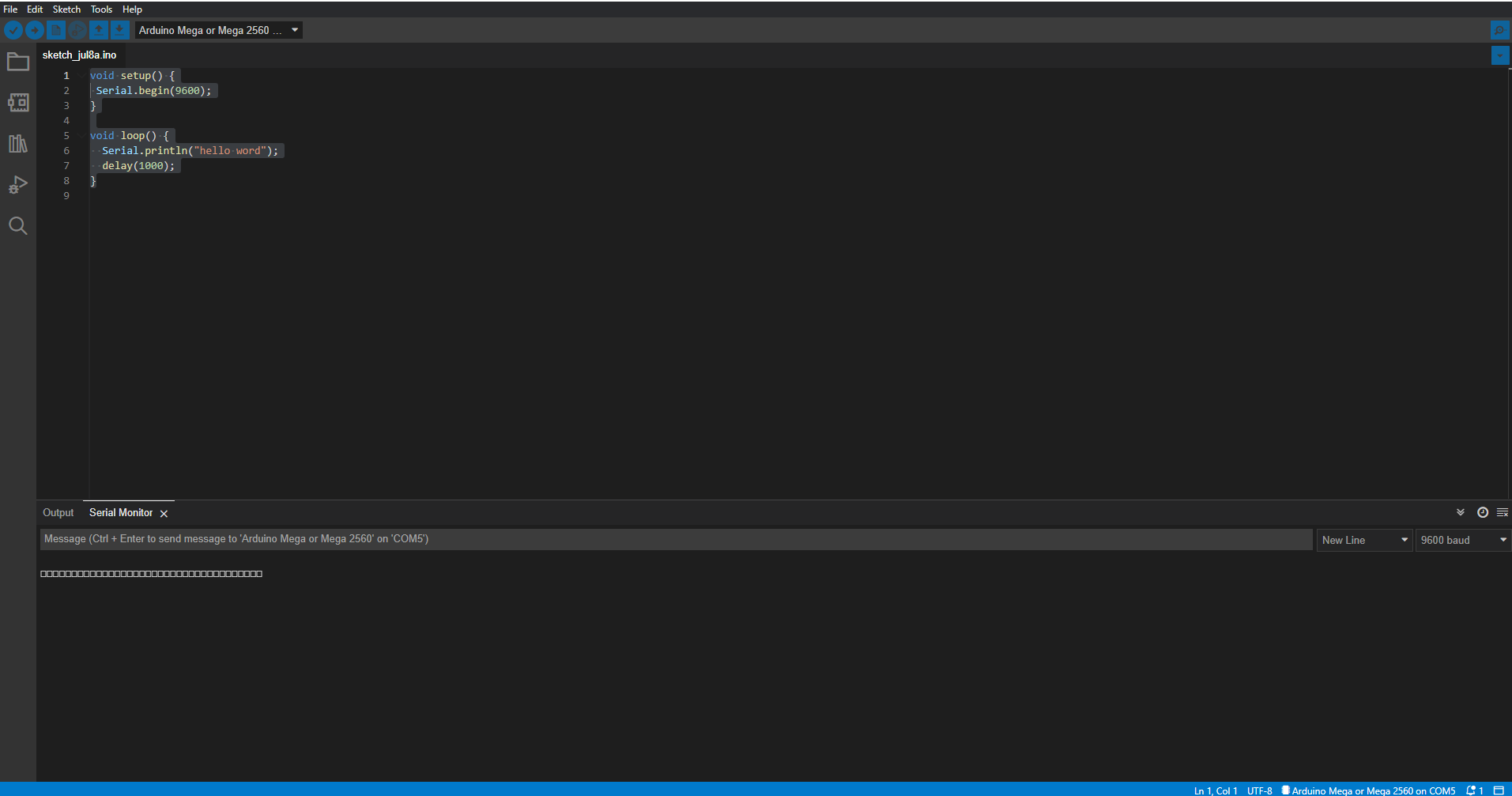

Hi, I am trying to use the Arduino ide beta 2.0. Uploading this code to My uno works fine, however when I try to upload this to my mega2560 I get unreadable output (of course I changed the board info and Com port). The same Code with both devices is working in old V1.8.19.
Any Ideas?
Serial.println("hello word");

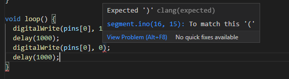

I am also experiencing those wrong error markings. Generally they seem to lag behind and are very slow. Sorry for adding this later, I forgot it in the main post.
Try chaning the baud rate on serial monitor to somewhere above or below 9600. Sometimes it randomly work for me. But I usually set my baud rate to 115200 on both
I tried this already, unfortunately it does not work ;(
I'm asumming everything works fine on version 1.8.19 on your end?
Hmm, looks like Serial Monitor in 2.0 is still buggy then...
(See Ralph S Bacon video on YT)
Its still in Beta so I guess bugs are to be expected. You cold log an issue here:

lukashoffleit:
Does the output continue printing, or does it stop after printing the number of boxes shown in your screenshot?
I see you opened a dedicated topic for this, which I think was a wise decision since it is a distinct subject matter from the Serial Monitor problem reported here.
I have responded over there:
In theory I really like the Idea of the new ide, the features sound great, but the ide is not really usable for me. I cannot really use the auto-complete, because it is really slow, so I would be done writing, if I wait for it. Also the automatic Checking takes a lot of time. Is this a problem from my side?
