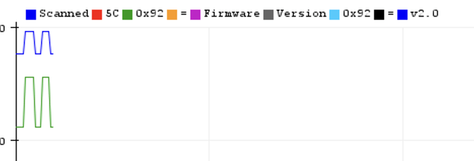

Serial plotter not working
I wanted to display the output signal waveform live in the serial plotter but it does not shows maybe I have something missing in my code .

what does the serial monitor display?
there's no display in serial plotter but in serial monitor the scanned UID is printed. I want to display the waveform on plotter
you cannot mix normal text output and plot data when attempting to plot - the text corrupts the plot
comment out the serial.print() statements such as "RFID = XXXXX"
just transmit numeric data to be plotted,
e.g. Serial.print(X); Serial.print(' ');Serial.println(Y);

You can mix text and data like:
RFID:1234 X:456 Y:789
and the plotter will use the text as labels for the legend and hover-over popups per:

I tried to upload your code in my Arduino it works the serial plotter display the sine wave . But Im having trouble displaying my output signal using RFID
I have tried those code and it work but I'm having trouble displaying my output signal with rfid
What output signal waveform?
How do you read the output signal waveform into the Arduino?
the output signal frequency generated by the circuit that I made with RFID

I do not see how that code would produce this legend:
Maybe try switching to the serial monitor and showing what output prints there.
For the serial plotter to graph sanely, each line should be either just numbers, or prefixed integers like:
X1:15 X2:77 X3:90
X1:16 X2:78 X3:91
X1:15 X2:77 X3:90
X1:14 X2:76 X3:89
If you want this chunk to plot 4 traces:
...you might write it as:
   for ( uint8_t i = 0; i < 4; i++) {
    readCard[i] = rfid.uid.uidByte[i];
    Serial.print("byte");
    Serial.print(i);
    Serial.print(":");
    Serial.print(readCard[i], DEC);
    Serial.print(" ");
    a += 3;
...to emit data like:
byte0:12 byte1:34 byte2:56 byte3:78
with the byte0...byte3 legend labels. But if you mix in lines with different formats, it will confuse the plotter.
Your graph shows a mix of odd legend text and three square wave looking traces. I guess that if you looked at the Serial.print(...) output in the Serial Monitor, you'd have a mix of line formats. Maybe a header line with the strings in the legend, then some alternating 3-value lines with what shows up on the plot .
