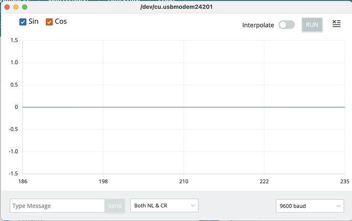

Many thanks for your reply, I have taken your advice and my altered code as shown below. However it only shows the Sin value and plot! I can’t see anything I have missed. I will look at your other points once I get this bit working. I am using IDE 2.0.0 if that makes any difference.

See below:
That sounds like a good option, I will give it a go once I get my main issue sorted. Thank you
I'm not able to reproduce the fault. The sketch you provided works as expected for me:
I was able to infer that fact from your screenshots. However, it is indeed relevant in regards to your question:

I tried using this sketch and the result is a flatline with no labels! What IDE version are you using, there would appear to be an anomaly with 2.0.0
It works as expected for me:
2.3.6
Are you really using version 2.0.0, or are you using that as an inaccurate shorthand to refer to the the Arduino IDE 2.x version series in general. I ask because the Arduino IDE 2.0.0 release is seriously outdated and many improvements and bug fixes have been made to the IDE since that release.

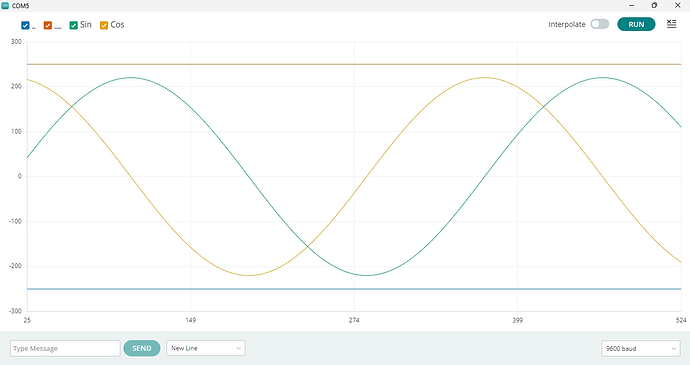

The serial plotter's window with your code in IDE 1.8.19
(I only changed the Serial baud rate to 115200 because 9600 is so old school).
There is a way of changing the IDE 2.x.x Serial plotter to display 500 points like the IDE version 1.x.x does.
(That would make it look like J-M-L's plot in post #9 .)
Details are shown how to do it at: https://forum.arduino.cc/t/serial-plotter-output-too-fast/1233965/9 .
I don't claim to be the originator of this information, the original work is by Alex-Tsyganok .
Yes was using IDE 2.0.0, however I have just tried the sketch on a laptop with IDE 2.3.5 and it works as you described. Many thanks for your help.

Here's the IDE 2.3.6 Serial Monitor modified to show 500 points, as mentioned in post #10:
You could even adjust it to plot 360 points if you wanted to display exactly one full cycle.
I believe the reason the sketch did not work with Arduino IDE 2.0.0 was because the developer of Serial Plotter did not provide compliance with all ssupported delimiters](Arduino/build/shared/ArduinoSerialPlotterProtocol.md at master · arduino/Arduino · GitHub ) when using labeled data sets. At the time of 2.0.0, the only delimiter supported under these conditions was the comma.
So you could probably make it work with 2.0.0 using this sketch:

Compliance with the Arduino Serial Plotter protocol specification was introduced later:
main ← nmzaheer:main
opened 05:31PM - 06 Sep 22 UTC
Part separator symbols as per SerialPlotter protocol i.e. Comma Space and Tab ch… aracters have been added.
This resolves #15
Please review and verify.
and that version of Serial Plotter was used starting with Arduino IDE 2.0.1:
