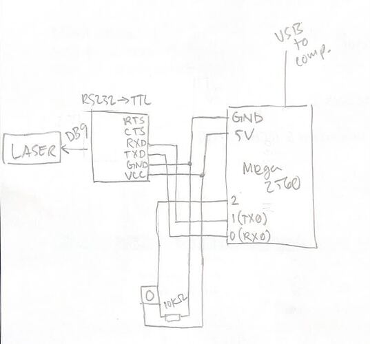

I'm attempting to send a signal via RS232 to trigger a laser firing. The only info I get is RS232 (9600-8-N-1), and the command syntax is "$FIRE 01CR". Only Tx and Rx are used, no other handshaking, CR is carriage return, 0Dh. Do I need to convert this into binary first? Or will the Mega2560 internally handle the signal and send as binary?
Below is my code, I'm using a button to induce a pin change from LOW->HIGH and detect the rising edge with attachInterrupt (I need the command sent only once, not repeatedly as long as the pin is HIGH).

I'm using an RS232 to TTL converter between the laser and the arduino, with pin 0 (RX) connected to TX, and pin 1 (TX) connected to RX on the converter. When the button is pressed, I see both TX and RX flash, so I assume that means there was some kind of serial communication, however there's no response from the laser.
Very new to C++ and still confused on how Serial.print works/how to format the command for RS232 communication. Any help/explanation would be greatly appreciated. Below is m wiring diagram. Thanks!
Based on your labeling of your sketch, I suspect you need to swap TX and RX, at one end or the other, unless you have documentation indicating that TXD on the converter is an output.
I also think your button is wired wrong. Pullup has to be between 5V and the input pin. Though, there's also the built-in pullup resistor if you enable it.

I would also suggest using one of the other serial interfaces (Serial1, Serial2 or Serial3) on the Mega to allow Serial to be used for debugging

Both print and write send out data on the TX pin. It's hard to say what is appropriate in this circumstance, hence the desire to know what the laser thing is, or a link to where you learned anything about controlling it. Maybe it's a laser and is a little harder to make go. :expressionless:
