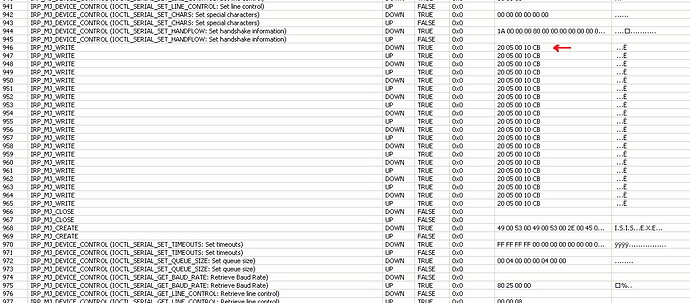

When I try send data with WinAplication, I have following Sniffer LOG(Free Serial Monitor), see attachment. (there string is sent as entire data)

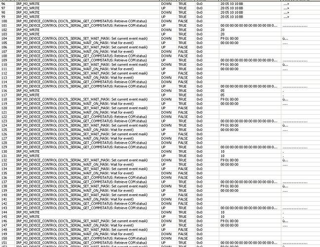

When I sending using Arduino, it seems that it sends like each byte apart, see attachment.

Unfortunately, this didn't work.....
I attached new screens...
So How you see Win app sends entire buffer, those 5 bytes cmd[] = {0x20, 0x05, 0x00, 0x10, 0xCB};
On other side, arduino also send those bytes, but separately.
Marked with red screens.
