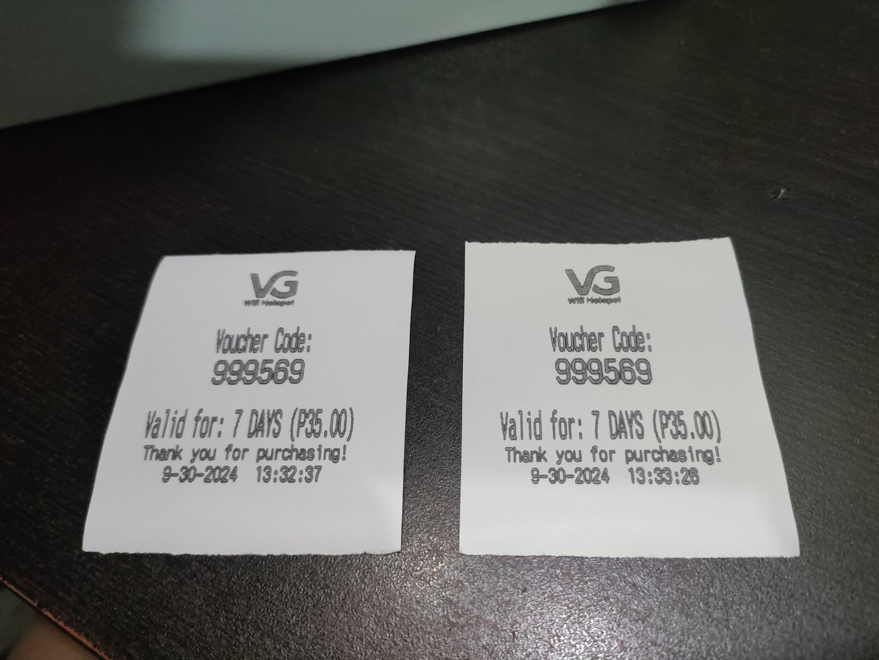

Hello there! Hope I can get some help with my printer as it prints garbage randomly (see pic below)
Thank you for the responses!
To be honest, there are a large number of sources of error.
Show the programme and the circuit diagram so that help can be provided.

Sorry for that paul! Here are the parts of my program that prints:

Hello
I´ve made a smal code review.
Move for a test this lines to the setup():
    printer.begin();
    printer.sleep();
    delay(1000L);
    printer.wake();
hth
Hello there again, paul. I moved this block to setup but the print out still has random characters:
Its only shows in the beginning of the print out
Hi there again paul, I removed this line:
printer.println(F("\n"));
at the beginning of the printVoucher() function, and lo and behold:
Thank you for your responses! Will get this thread updated once the garbage printout shows up again :blush:
