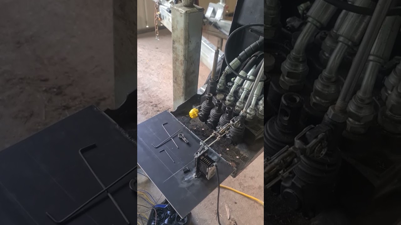

I have a trailer with a hydraulic crane attached.
Bought it with manual lever actuated hydraulic valve.
Changing valve or buying OEM remote kit for it is minimum $8K.
Decided to do it on the cheap and learn Arduino/servos.
Already designed my linkages and mount(needs re-enforcement, too much flex, easy fix, will do later).
Concept works, just needs tuning.
My problem:
As per video, servo is too jittery and erratic . Can't have this with a crane that can carry 3.5T

From what I read the servo jitters but the servo position sent to the servo is stable, correct?
Jitter is power supply. Wires. Sized correctly? Wires connections? Show an image of the project. Can a schematic be posted?
From what I can tell from watching the MCU could be resetting.
Thanks for the reply.
Yes signal sent to the servo is stable and servo pos read from the servo is stable.
Everything is on a breadboard and pretty janky for now but wires in servo supply circuit are bigger than wires that come standard with servo and white signal wire is thicker Automotive gauge. Joystick tiny but that signal is stable.
The only thing I can see that could be wrong is that the servo is too weak to handle the mechanical load. Otherwise the wiring looks good.
What is the rating of the BEC? I highly, highly doubt your peak current draw is accurate, more likely the BEC is momentarily shutting down because of overcurrent. The generic small hobby servo can draw 1A or more under heavy load.
First, identify the real problem.
If you disconnect the servo from the load and send it a fixed value, e.g., myServo.write(100), does it still jitter or is it stable?
That can't be correct for a servo with torque in the range of 30-40 kgf-cm. I would expect a start/stall current of over 3 Amperes, which the servo will draw every time it starts moving.
The problem is clearly the servo power supply.

Hard wiring the servo power directly to one of the 6v batteries (no fuse no fuss haha) with a deutsch plug solved the issue.
Peaked at around 3.6A after this and no jitter.
BEC was rated for 5A. Not sure why it could handle it. doesn't matter better now that I don't need it anyway.
Thanks for your help
BEC is rated for 5A. Not sure why it had dramas. But didn't need it anyway.
Definitely right about current. Pulled 3.6A after I hard wired it to 6v battery.

Peak or continuous?
There could be short-duration current spikes in excess of 5A. You would really need an oscilloscope to see something like that since a meter tends to average over time.
