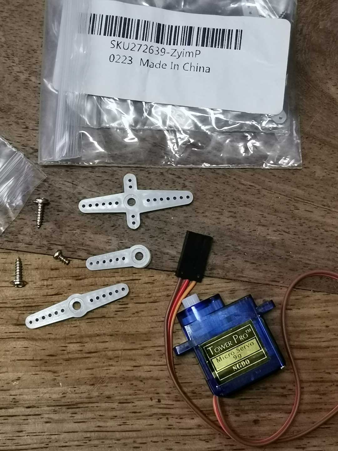

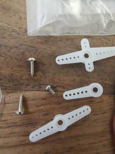

Just as an indication here are two pictures of my SG90s as they arrive from China (Banggood six packs).
The short screw is intended for the horn and all measure 2mm external across the threads. They are all a type of self-tapper and seem to work OK. Hope that helps.
Edit: Just checked. The hole is unthreaded and a loose fit for 1.5mm but smaller than 1.8 (the only drill bits I have). If I decide not to use the supplied screw I would tap it to 2mm.
Just tried that. Tapped to M2x0.4 and it works great. 5mm deep.
Willem.
