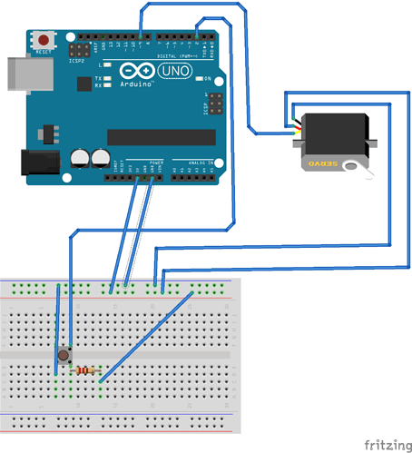

Hi guys, this is my first post, and i'm not the best with arduino yet. I'm trying to build a circuit which will turn on/off servo when the button is pressed. And i can't get it to work at all at the moment. What am I doing wrong?

One of these comparisons is wrong.
Can you tell us what that code should do ? Should it turn the servo by some angle after you press the button ?

Servo should be turning an angle when the button is pressed, as I said earlier. My circuit is connected as you can see on attached picture. However, my circuit and / or code don't seem to be working together, and at the end I'm getting no reaction...

Why doesn't the first conditional pair move the servo?
i can't see what's wrong with code, any suggestions?
Have another look at reply #1

I looked at it again... still can't see what's wrong with it. Beginnings are so frustrating :frowning:
either:
directionState == 0
or
buttonState=HIGH
is NOT being set (correctly)
*usually
= means assignment
== means conditional check
