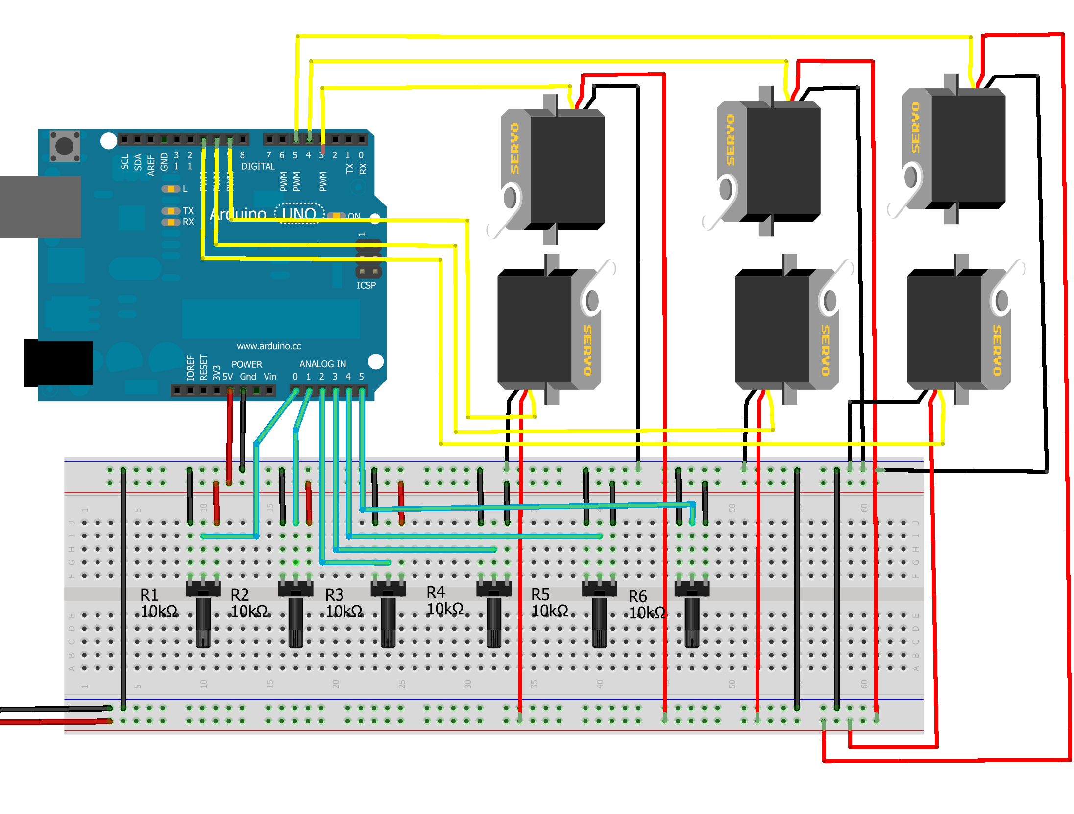

Seing if this JPEG file stays attatched, This is the picture of my wiring...
I used 50k potentiometers instead(cos thats what i had) of the 10k sugested.
And with that code sketch that Robin2 fixed up for me it all works perfectly.
Im blown away iv managed to actuly compleete a arduino project i customised to suit me.
All my parts iv made by hand my self, And once its all assembeled i shall post some more pics of it all together.
I realy want to get it all on a prototype board tho.
I have seen somewere that the external power source coming in should run through a "voltage regulator and then a capacitor of some sort, And then branch of at the capacitor to connect other servos..(ill look for of picture of it aswell).
Ops circuit;
A 0.1uF capacitor on each of the pots analog input to gnd, will also help.

Sweet, Thanks for that Tom, Now people can 2 and 2 together.
Silly question for ya, Im sorry if im a little nieav to some of this, Are you refering to the blue wires ?
This is the sort of thing i had in mind

FYI: Here is the roughly equivalent sketch using arrays and structures. I switched to Servo.writeMicroseconds() which has better resolution than Servo.write(). The settings structures allow for limits to the range of values expected from the joystick pots, allowing full range of control using physically limited inputs. The settings structures also allow for limiting the range of motion of the servos to avoid hitting physical constraints.

Wow, Thank you very much john, Nicework.
