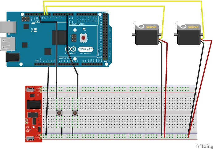

Hi all, I'm trying to detach my servos after every move to stop the buzzing/jitter. I tried using the .detach command after write(angle) and then .attach after digitalRead(RIGHT)/(LEFT) == LOW but it doesn't want to work. I am new to coding and looking for some help. please see the code below.

Fritzing Layout
If your servo power supply cannot provide 2 Amperes, replace it with one that can. 4XAA batteries will work for a while.
Current capability of a breadboard supply is very low.
It might be able to power one tiny hobby servo (if input voltage is low enough), but not two.
Leo..
MG996R are power-hungry servos. Connecting them via a breadboard is unlikely to work well. Try it with 4 x AA NiMH rechargeable cells and more solid power connections.
The code looks o.k. So when you say "It does not work" do you mean that it does nothing at all or do you mean that the servos work normally but the change did not cure the buzzing?
Personally I'd have put the attach commands immediately before the writes. There's not much point reattaching the servos if you're not going to write to them.
Steve

Thanks for all your input guys. I have had a play with the code and I have kind of got it to work. The servos move and detach at the end of each move and reattach when the button is pressed as it should. Now, the problem I am having is that when the Arduino powers on the servos won't go back to 180 degrees (home position) which it should do. Do I need to add any delays or other commands for when the Arduino powers on?

Quick update.
I did what every man does and took the servos apart!!!
It turns out that the gear that turns the pot is snagging in a guide within the housing and not allowing the gear to sit properly which in turn is giving a false position for the pot.
a quick scrape and clean has eradicated the buzzing.
problem solved.
I can now revert back to the original code and not have to worry about detaching the servos.
Thank you all for your input.
