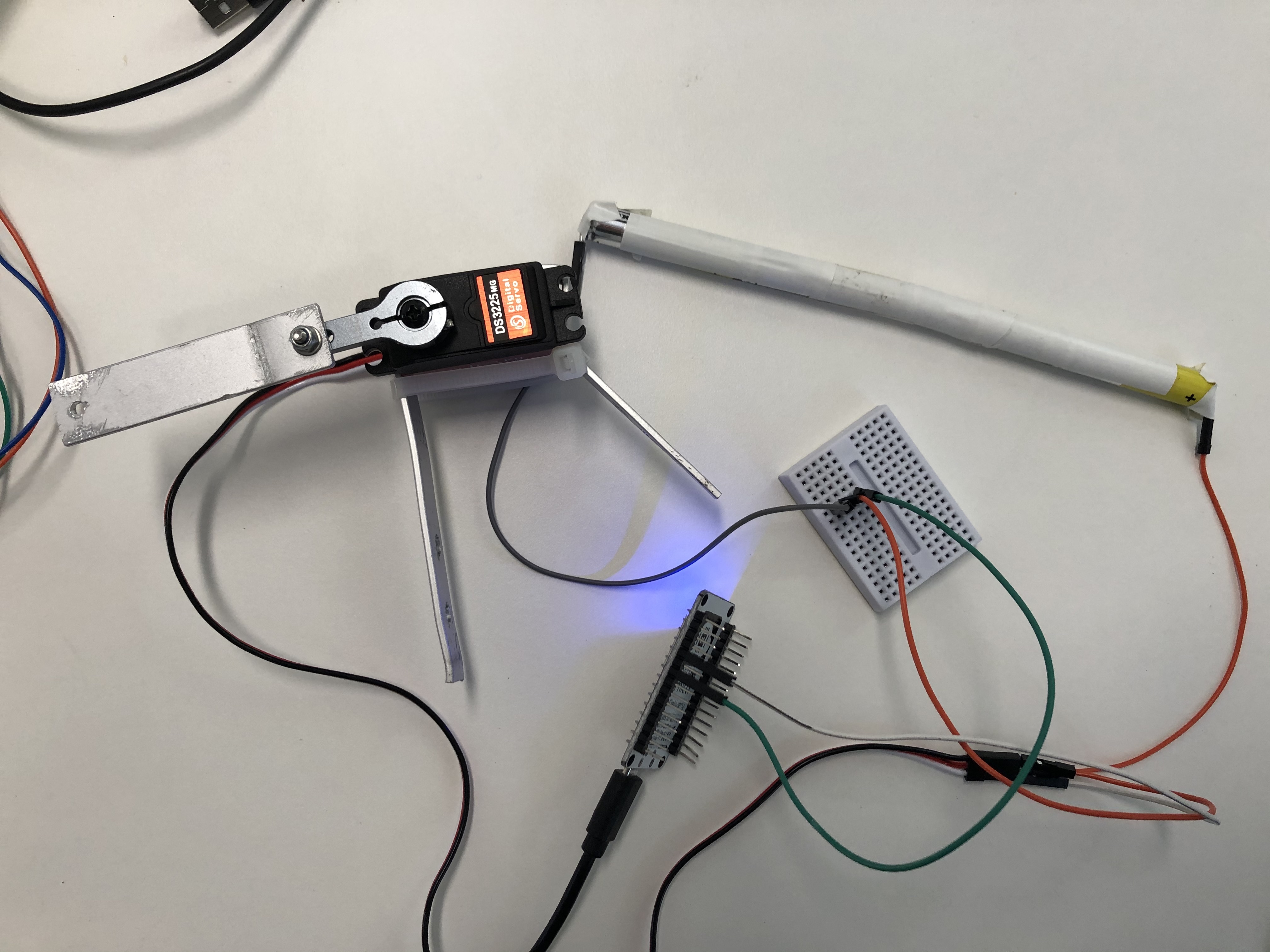

Hi everyone, can you tell me why with this configuration (img attached) the DS3225MG servo doesn't work?
Do I need to add parts to the circuit?
The goal is simply to make it rotate 0-180 ° with an ESP8266. Everything works perfectly with SG90 servos...
Thanks for the help in advance.
Probably not enough power. What's the power supply specification?

I'm powering the servo with a power bank. Specifically one of these two:
  • Output 5V 2.4A (10,000mAh)
  • Output 5V 2.0A (5.000mAh)
Those power banks sound like they should have enough power for the servo. You could try using 4 x 1.2V NiMH AA batteries which aren't current limited to see if that helps.
If the servo still doesn't do anything one other possibility is that your particular servo can't tolerate a 3.3V control signal (they normally expect 5V). Can you try level shifting the control signal to see if that makes a difference? See How to interface a 3.3V output to a 5V input. – next-hack.com for many ways to interface a 3.3V signal with a 5V device.

Thank you. I did the little test you suggested and it still doesn't work. (am I stupid?) [img attached]
