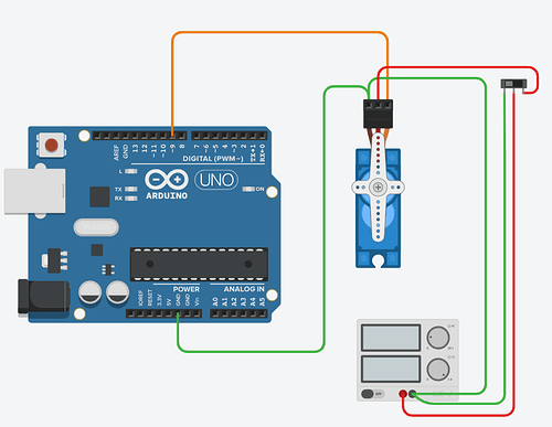

I'm using a servo to operate an indicator for a pressure gauge (simulated for fun, not exact). The operation I wish to achieve is as follows:
  1. When toggle switch is flipped on, gauge (servo) rotates to 90 degrees
  2. When toggle switch is flipped off, gauge rotates back to original 0 position.
    (Much like an oil pressure gauge in your car)
I can get the first part thanks to interwebs, but it's the second half I'm not sure of. I'm fairly certain I need to configure a pin to the toggle switch instead of only using it as a power switch as shown in the image below.
Here's the sketch
#include <Servo.h>
Servo myservo;
  myservo.attach(9);
  myservo.write(90);  // set servo to mid-point
void loop() {}
Why do you have a ground and a V+ wire to the switch, that could short out your power supply?
Run a wire from the right end of the switch to ground, another wire from the center pin of the switch to pin 2.

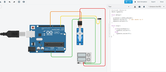

Which simulating software you have used to design this image? It's so elegant and it's not of Fritzing. Can you please let me know the software. Thanks in advance !!!
outsider:

Thanks for the reply, I was in a hurry when i made the diagram. I'll try this out and get back to you.
TinkerCAD from Autodesk. It's free and you can do quite a bit and very easy to use. I like fritzing, but I prefer the simplicity of TinkerCAD.
Thanks Outsider! It worked like a charm, very much appreciated :slight_smile:
